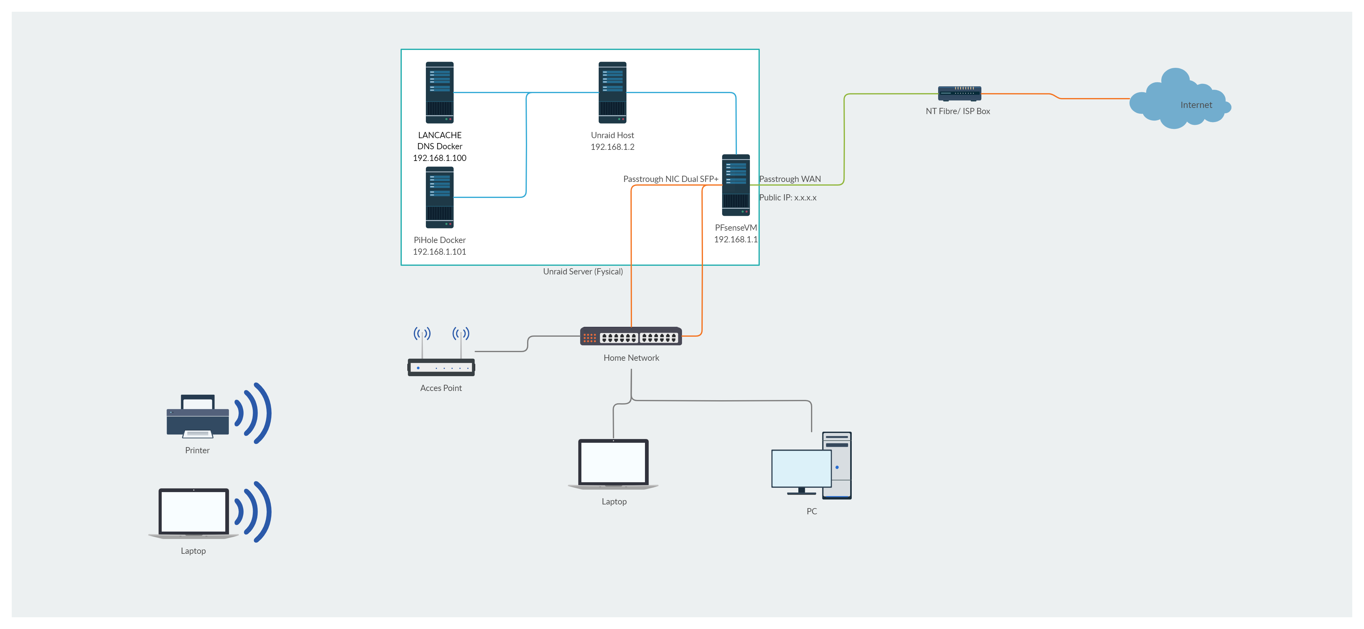

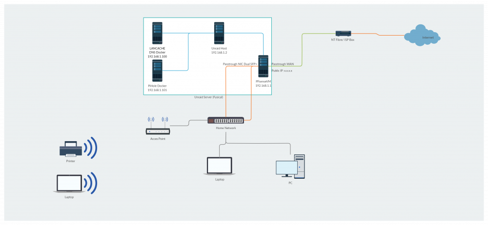

  22. Is anyone interested how to setup: Pfsense VM as firewall; with onboard NIC pass-trough as WAN, pass-trough Chelsio SFP+ PCIE-card for home network. Virtual 10g+ network for Unraid GUI and dockers. And with lancache DNS Docker, Pihole Docker for network-wide add-block without changing the settings of other devices. I'll probably not explain Pfsense settings as well as others, because i'm fairly new to it. But general settings for bridging will be covered. I run other dockers and VM's for a while now (4+ years I think), guides and videos about these are covered well by others. So I'll not cover those, but I could not find a good guide to setup the following and I spend a lot of time researching. Maybe it could help someone. Like this:
