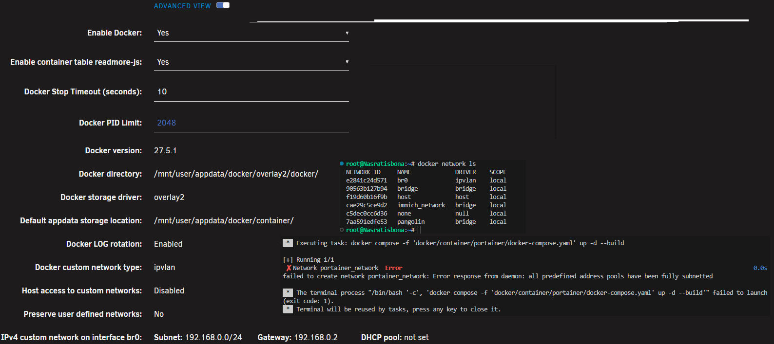

Failed to create network - "All predefined address pools have been fully subnetted" - Unraid 7.2.3
Hi guys, since changing from docker on "image" to "directory" with overlay2 i have problems starting my containers. I do not know where the problem with "all predefined address pools have been fully subnetted" comes from. I already tried to switch to macvlan and back to ipvlan, but i was not successfull with this idea. Would be great if anybody can help me. The compose from the following example is: Thank you

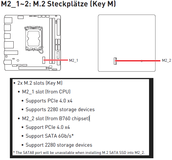

Reduce power consumption with powertop
I recognized that my system can reach C10, if the NVME Cache is connected to the chipset instead of directly to the CPU. I do not really understand why, but if the NVME is connected directly to the CPU i only reach C6. Does anyone know why this happens ? Unluckily the bottom slot has no additional cooling. To be honest the power difference is not that big between C6 and C10 in my case. System: CPU: 12600K Mainboard: MSI B760I Edge Wifi RAM: 32GB DDR5
