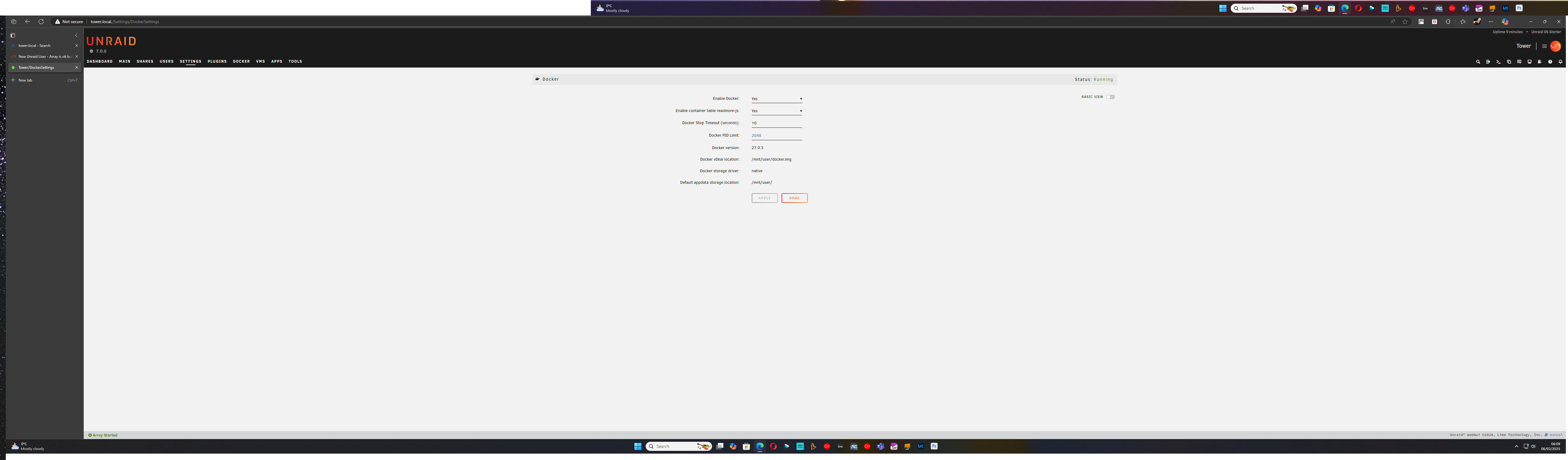

Doesn't look like you did the Docker changes at all.
Go to Settings - Docker and post a screenshot.
OK sure hereScreenshot2025-02-06061000a.thumb.png.28e5d58853c4d8ee4ee58ed0171527b5.png is the docker screenshot.
I do see now that the changes i made following your suggestions did not save, even though I sleceted apply in Docker.I will try again.

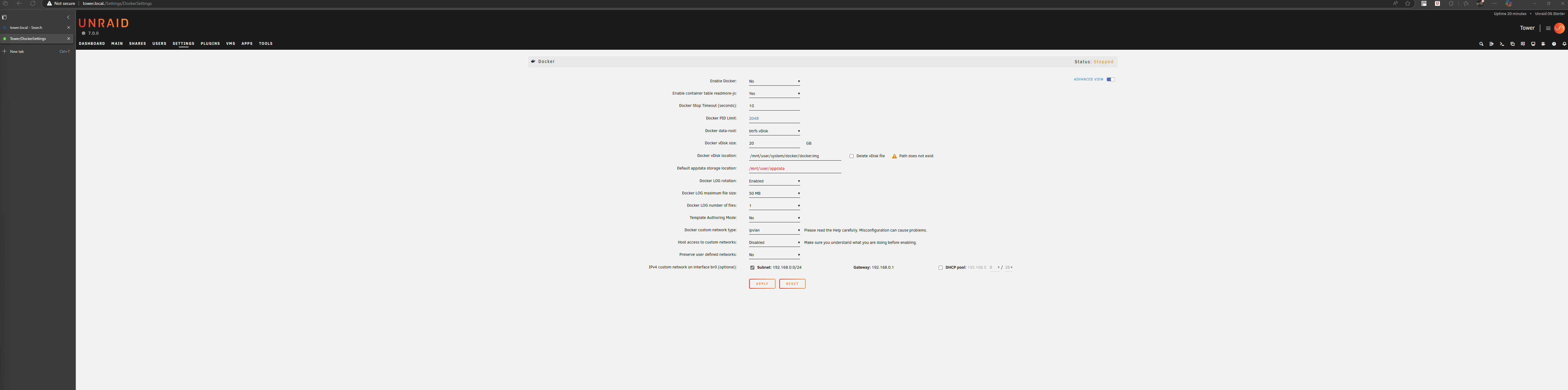

I get error messages on applying the suggested settingsScreenshot2025-02-06062051.thumb.png.2822ed9d9cdfb129da3b88812efb938c.png?
put a "/" behind appdata
