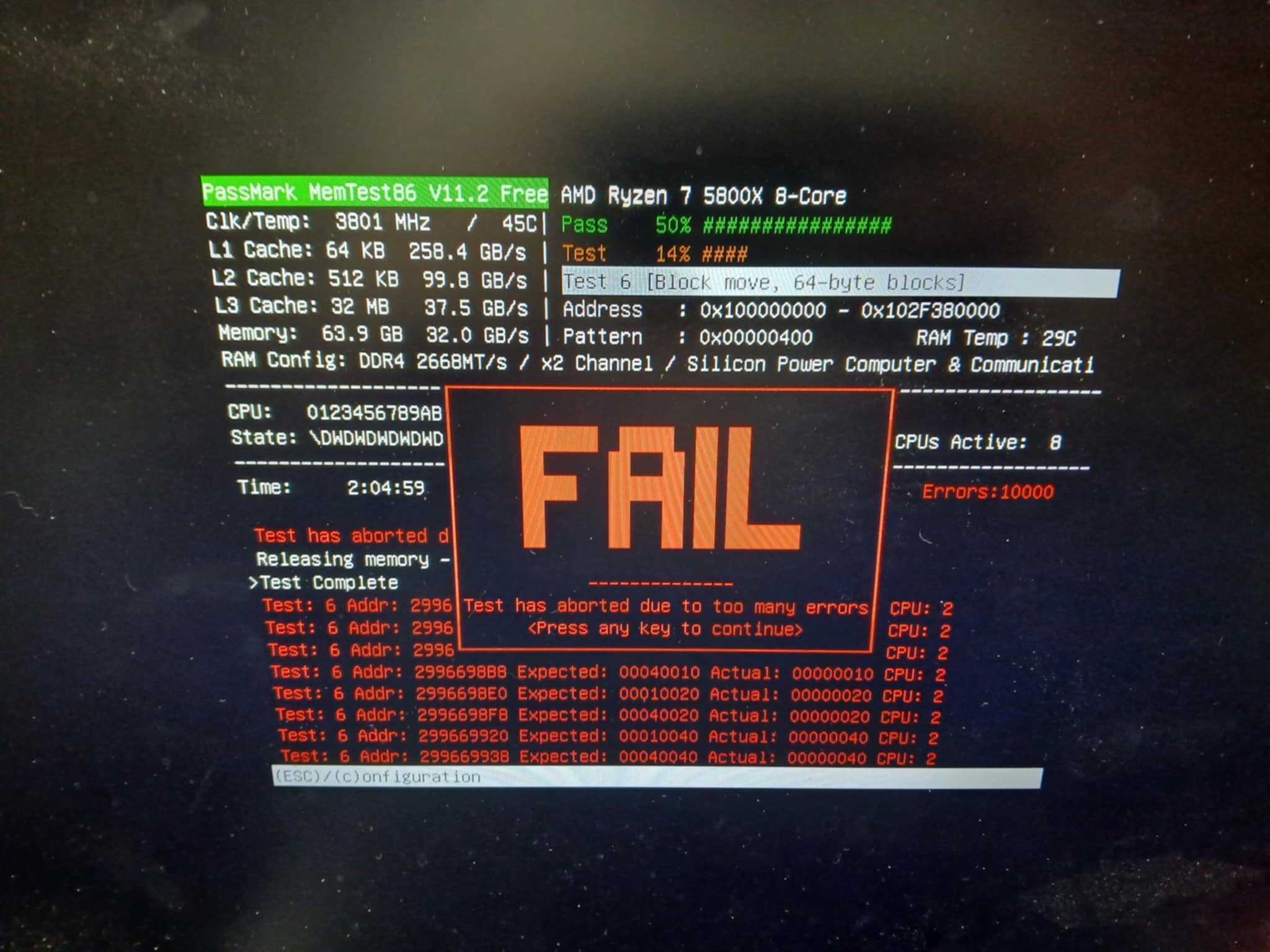

Well, that's not good.  3 out of 4 sticks are bad.
Edited by tgotr
dont give up so early.
It is well known that many Boards cannot run the RAM with the desired speed.
Try to lower the frequency to 2400 and try again. DO NOT USE THE XMP SETTINGS of the RAMs, do not overclock!

I had bad ram sticks, failed testing at slower speeds. 3 our of 4 sticks went bad, but not in a way that kept the system from POSTing. With the RAM being bad, I moved the docker.img to one of my cashe pools and docker is stable. I pulled DDR4 sticks out of my main rig, and the ram sockets tested fine.
