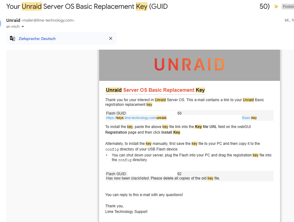

It asks for the email so it can send you the replacement key that way. It does know which GUID it had before as you can see below.
Ending with "50" was the new USB Drive, ending in "92" was where the key was before
Edit: I should mention, that you do need to have that particular key, for that particular old GUID.
