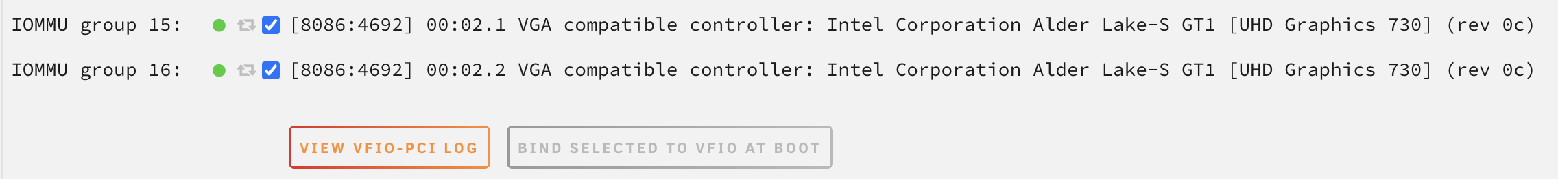

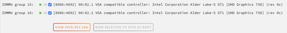

Spent the last couple of days trying to solve this issue: checked and unchecked IOMMU group on Tools - System Devices (bind to vfio and reboot).
Currently I have 2 VM on my system: HA and W11 (which has my iGPU passed through).
Here are some more information:
root@Tower:/var/log# cat vfio-pci
Loading config from /boot/config/vfio-pci.cfg
BIND=0000:00:02.1|8086:4692 0000:00:02.2|8086:4692---
Processing 0000:00:02.1 8086:4692
Processing 0000:00:02.2 8086:4692
Devices listed in /sys/bus/pci/drivers/vfio-pci:
vfio-pci binding complete
root@Tower:/var/log# cat vfio-pci-errors
Error: Device 0000:00:02.1 does not exist, unable to bind device
Error: Device 0000:00:02.2 does not exist, unable to bind device
Is there anything else to do to solve this issue?
Thanks in advance
Edit: Unraid 7.0.0
Edited by lsljunior
add information

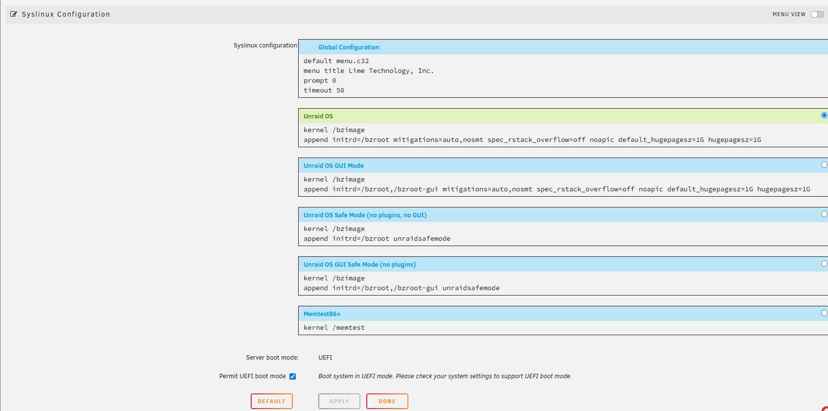

It looks like your trying to pass your igpu... passing the onboards graphic process is hard and not recommend...
*As you essential will be cutting the processor in half to pass the gpu part which can be problematic... not impossible...
you may need driver install:
what is the output of the kernel driver in use for the uhd from command
lspci -v
as you want the bound device to say:
you may need extra grub option to rip out and stop the frame buffers on the cpu.
review some info here...

we may need to fix FB and add adition vfio settings to grub:
WebUI > Main > Flash > scroll to bottom syslinx options...
example:
I would have you run:
kernel /bzimage
append initrd=/bzroot video=vesafb:off,efifb:off,simplefb:off,astdrmfb initcall_blacklist=sysfb_init acpi=force acpi_osi=Linux pci=nocrs irqpoll vfio-pci.ids=8086:4692
with VM Settings:
