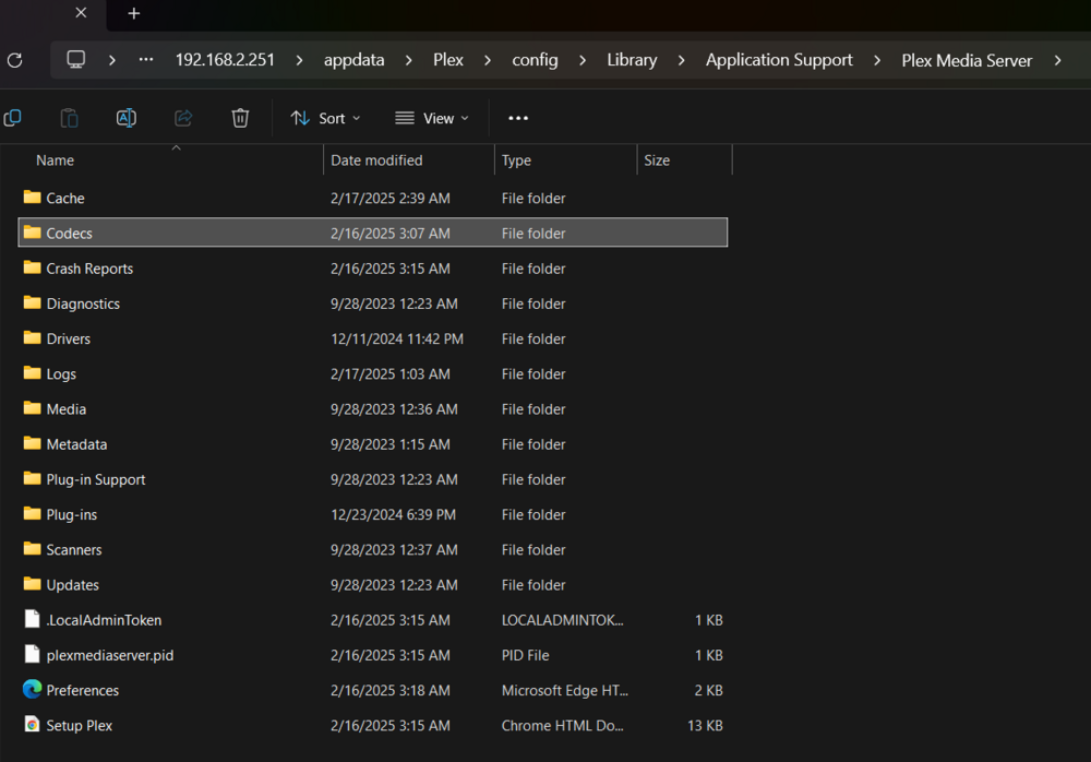

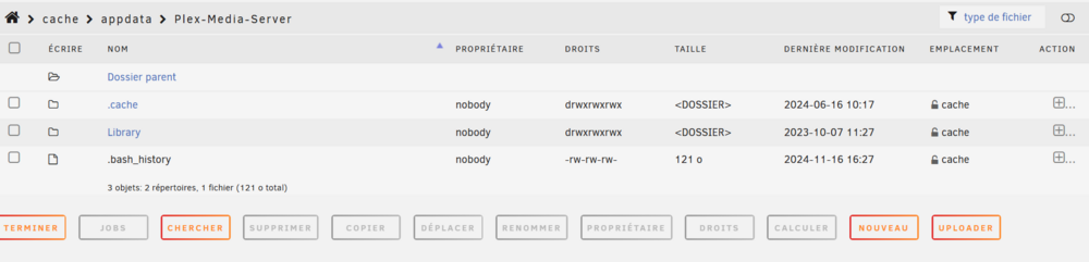

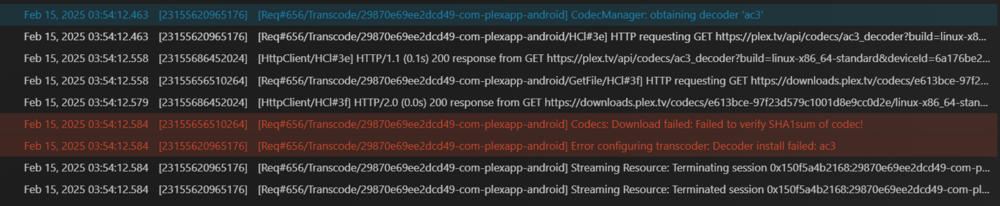

Hello, after a lot of problems because of Windows and Unraid authorization I had to start from scratch on a lot of things. I have a problem with PLex and transcoding. I saw that the problems often came from the codecs and deleting the file allowed me to start again on a good basis. The problem is that Plex doesn't want to give me the "EasyAudioEncoder" folder and I think the problems come from here: screen. I tried to restart and even delete plex, nothing to do. Is there a way to manually put this folder? Sorry for my English.

its a known plex issue and plex is wokring on it...
This could also be folder permission based...
stop all docker run unraid docker safe permission...

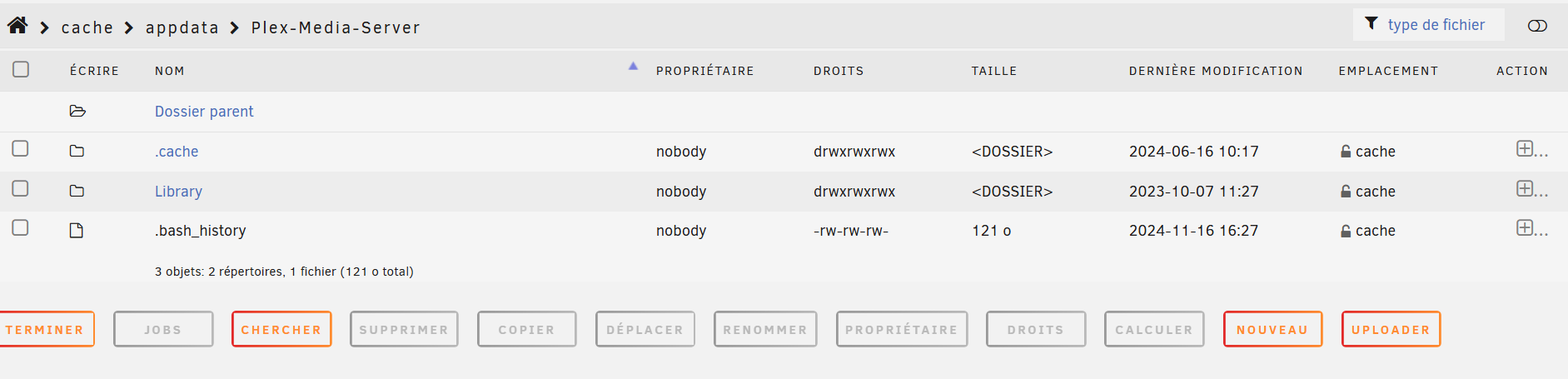

I also think there is an authorization problem. When I try to add a file directly to appdata/plexmediaserver/codecs I get an error message telling me that I don't have permission. However, I seem to have configured it well. Do we also need to do something on wondows?
your fighting samba share permission and unix permission...
you need to run chmod 777 -R and chown nobody:users -R in the plex folder on unraid...

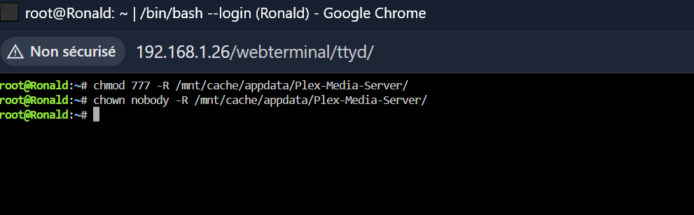

Can you give me the exact order please? Sorry I'm lost with the commands

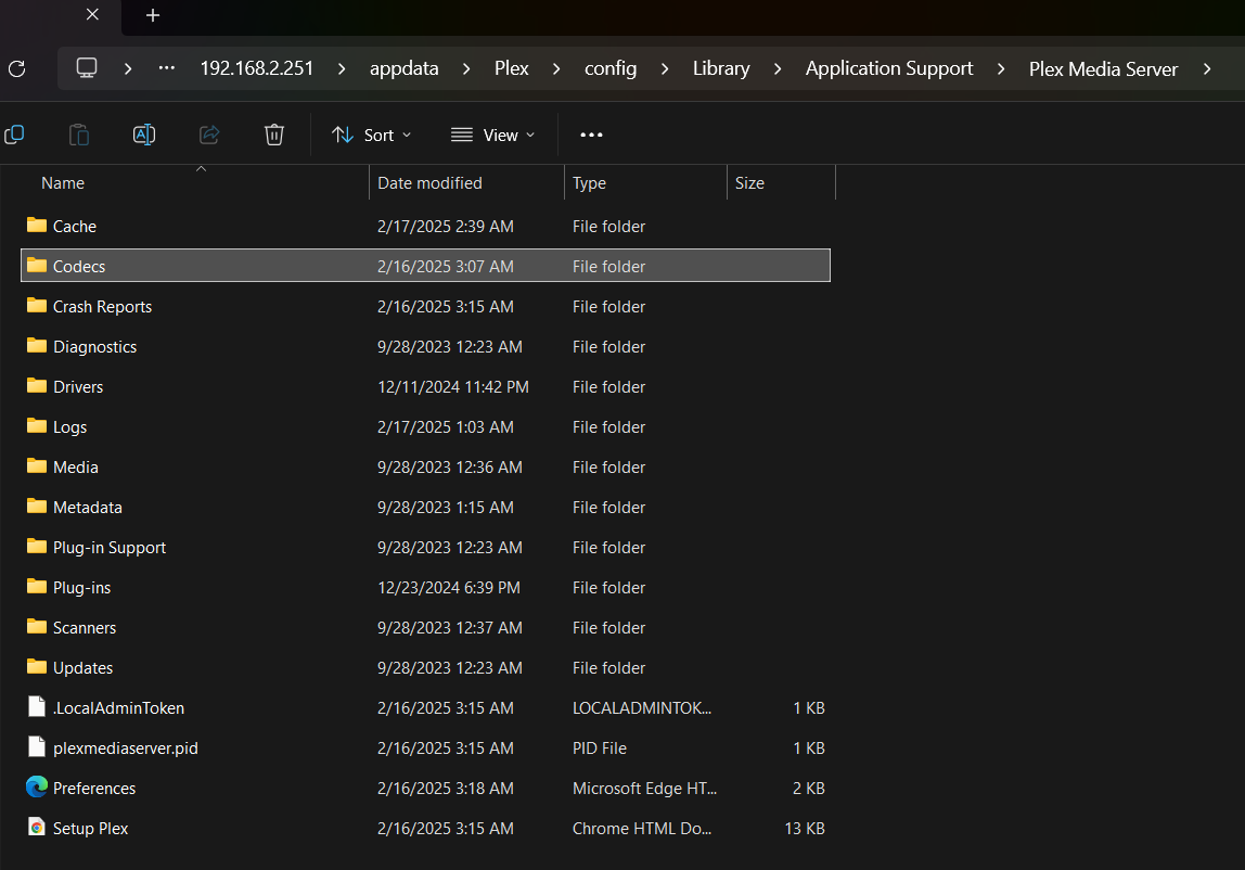

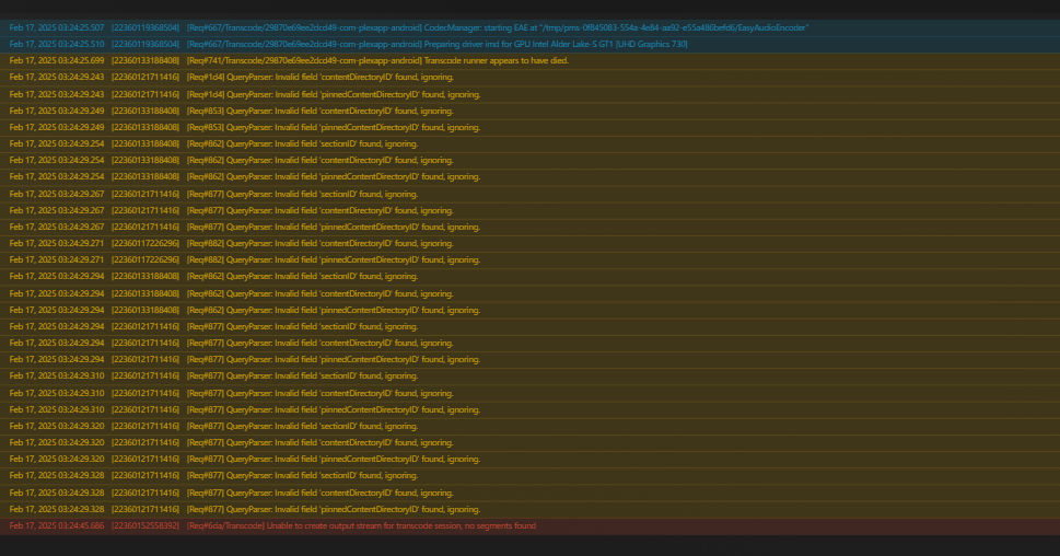

EasyAudioEncoder reappeared, but still a transcoding problem under Unraid with this message: Transcode runner appears to have died.

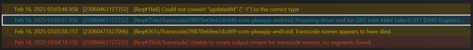

Here are the error messages on Plex:

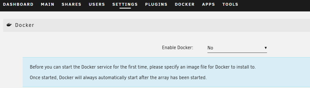

Steps:
TURN OF DOCKER! NOthign running. Array mounted only!

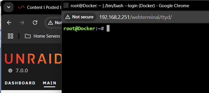

open the unraid web terminal:
in the termianl you need to move into the folder where plex is located.
Fix Permissions:
chmod 777 -R /mnt/users
chown nobody -R /mnt/users
You can run the above command to set and fix permission in unriads fuse /mnt/user array this will touch every file and set the correct permission...
when that has finished.
turn dockers back on...
Edited by bmartino1

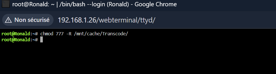

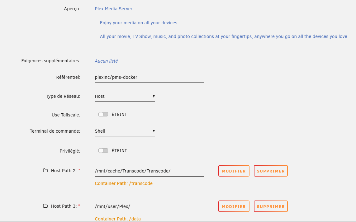

Hello bmartino1, I successfully carried out the manipulations, but still having problems
I even did a chmod -R 777 on the transcode folder

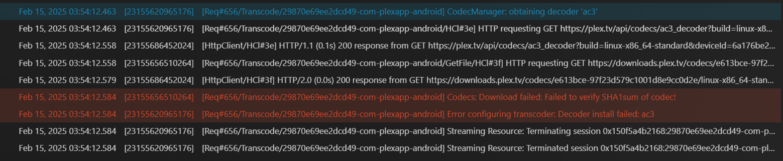

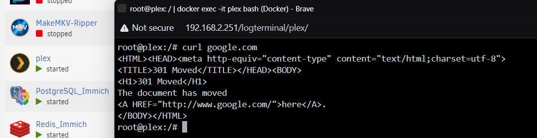

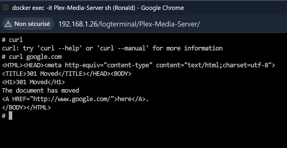

can plex reach the internet console the docker and run teh curl commadn against google
As Plex need to internet download some files for transcode...
*There are some known issues atm with the confi and tracode that plex is aware of and working on them...
Some users have reported sucess after deleting the codec folder and having plex redownload this fodler.
as seen here.

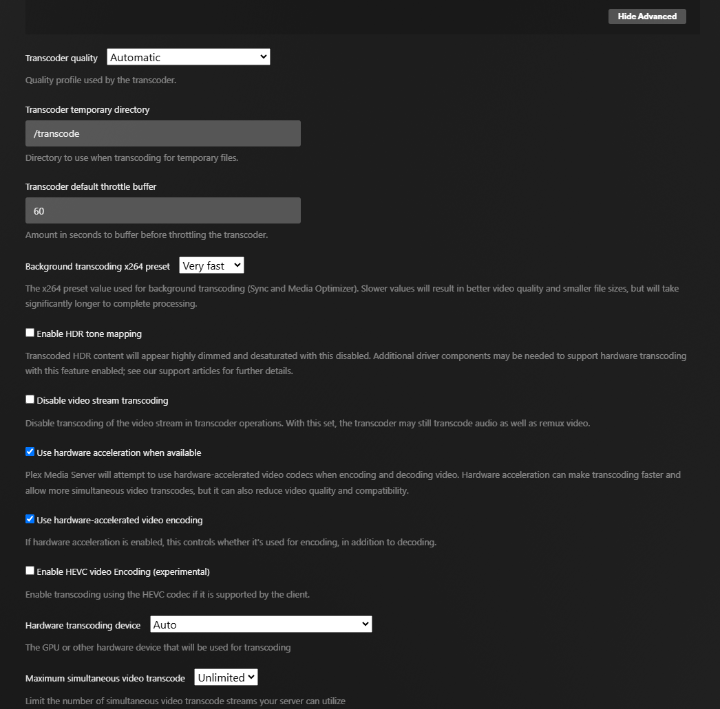

Verify your settting per this post:
Hello, I successfully performed the curl command on Google. I also saw the recent plex problems, but the codecs reappeared two days ago. I just noticed that if I take low bitrate files and I go through MANUAL transcoding it works every other time (never automatically) but the processor suffers enormously in addition to having buffering. And to make matters worse, I no longer have permissions to move files between my disks.

to fix transcode issue my self I have readjusted my transcode needs and currently able to pull live OTA TV and watch them on plex via Transcode for tests:
https://support.plex.tv/articles/115002178853-using-hardware-accelerated-streaming/
Its worth a try.

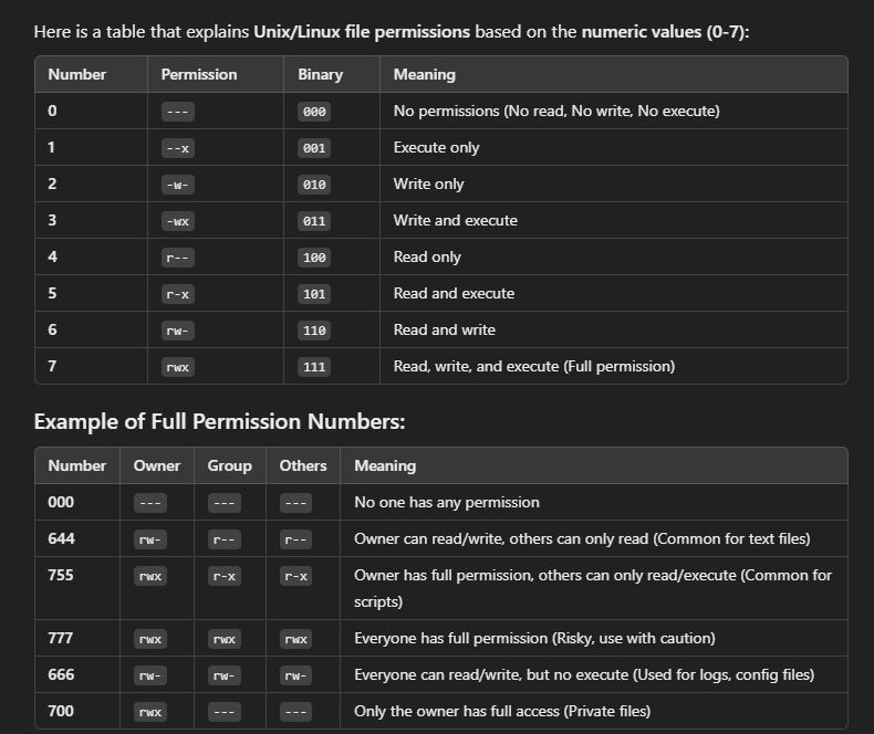

Ideal you would use user 99 for nobody group 100 for users and a umask of 022 that sets unix permissions to read via group/ world..
Lets review Linux file permission table:
permission to:  user(u)   group(g)   other(o)
octal:            6          6          6
binary:         1 1 0      1 1 0      1 1 0
what to permit: r w x      r w x      r w x
binary         - 1: enabled, 0: disabled
what to permit - r: read, w: write, x: execute
permission to  - user: the owner that create the file/folder
                 group: the users from group that owner is member
                 other: all other users
Dockers ideally use the group and world permissions. The docker runs as user root
the user nobody is essentially the equivalent guest user any user...
While user root is essentially the equivalent administrator user full access user...
Please fix your file permission and add the necessary variable to fix docker file access and permissions...

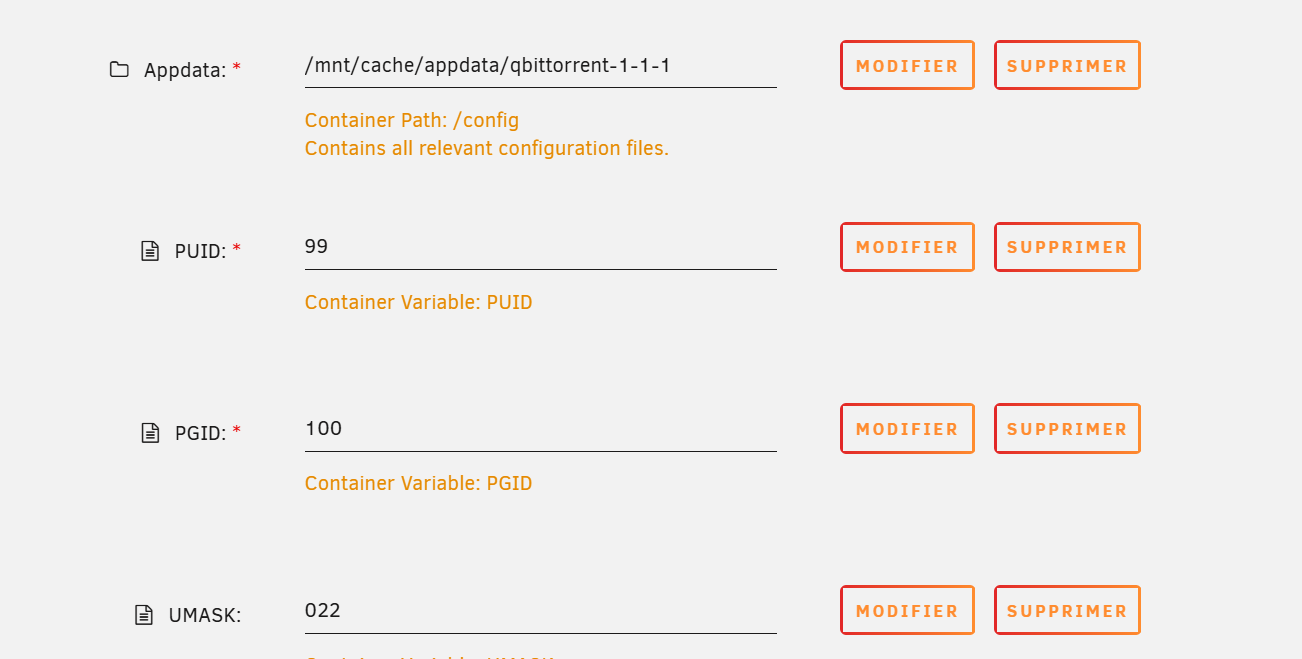

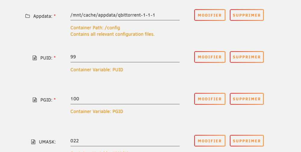

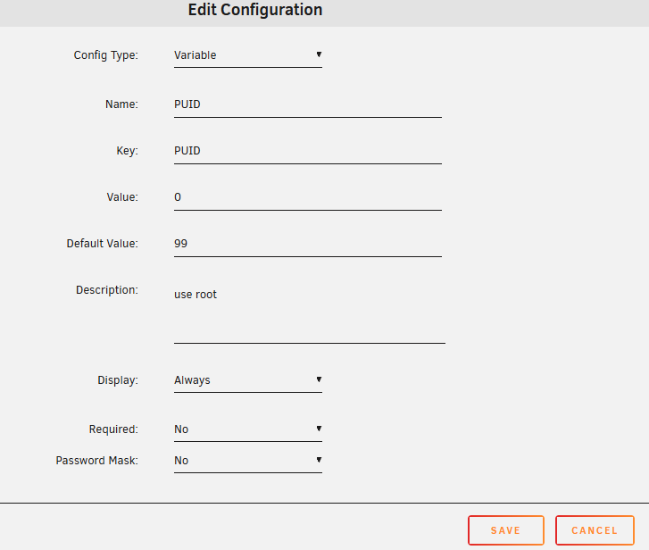

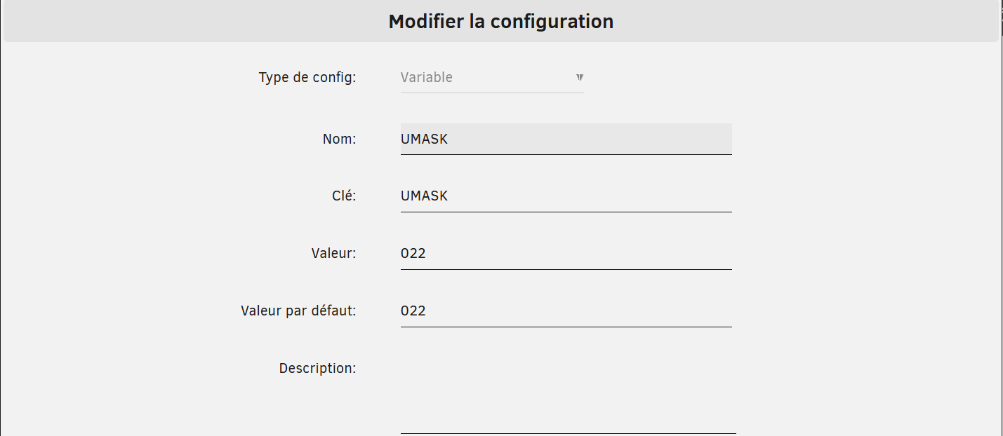

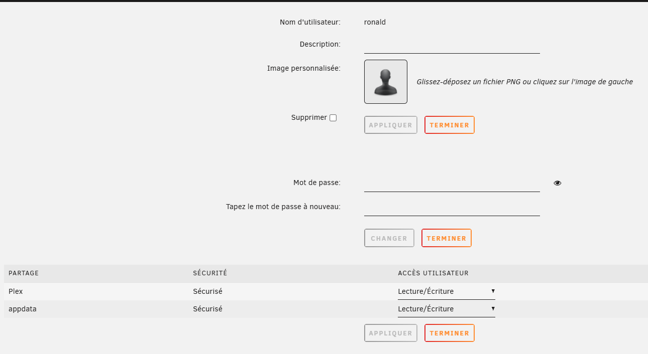

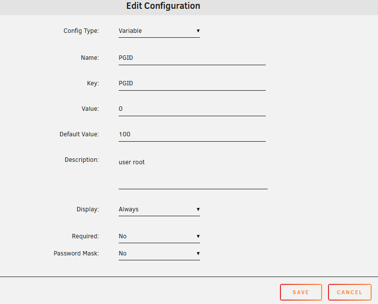

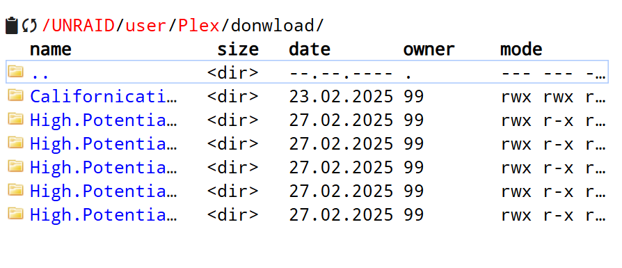

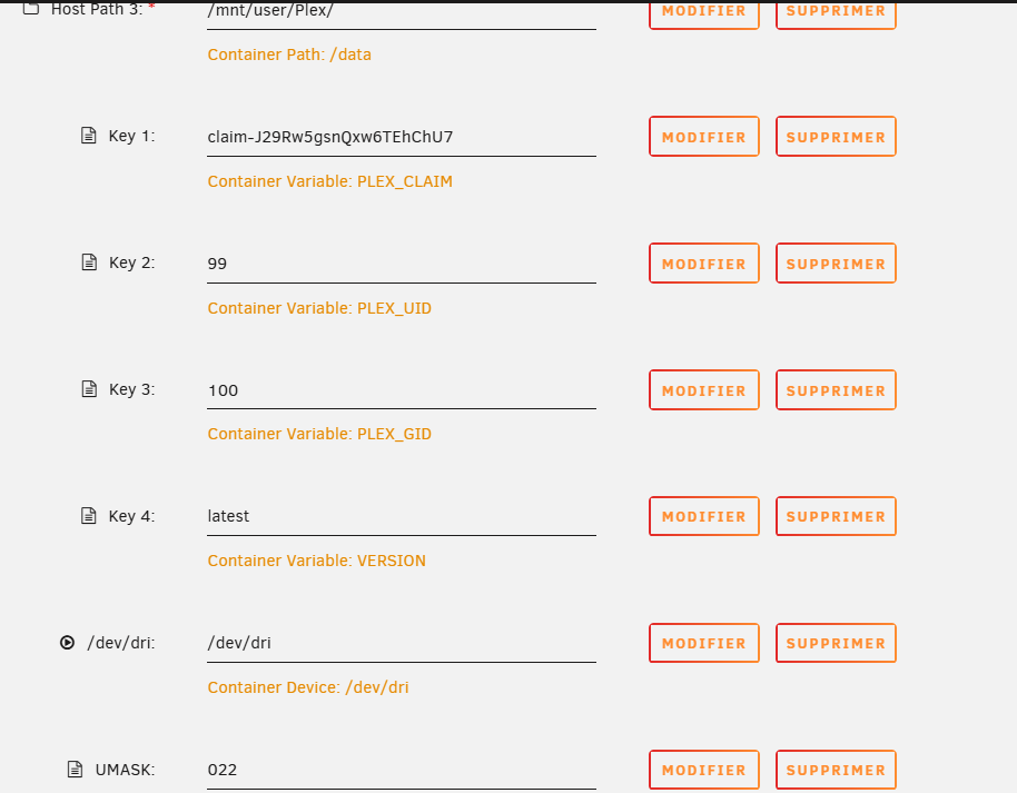

I checked the qbittorrent settings which I think are good (screen 1) But as you can see on the second screen I do not have full access to the recently downloaded files. Except for Californication, without knowing why...

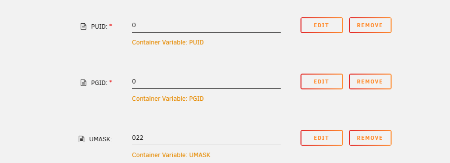

I looked for Plex, couldn't find the umask variable so I added it manually. I don't know if I did the right thing?
