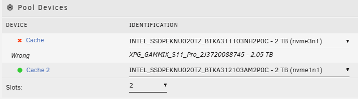

So I just went to put back the original Intel 2TB in unraid server, so its the original dual Intel nvme drives, but getting:
I'm guessing that the issue is that the XPG is reporting 2.05TB and the Intel drives just 2.0TB and so I need to use a larger drive to get the array to start?
Am I able to go to 1 slot using the Intel cache drive with data on it, start the array without formatting the cache drive, stop and re-add the Intel drive back to mirror cache pool?  All without losing data? It doesn't look like I can select 1 slot.

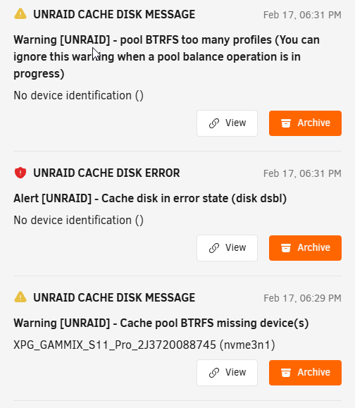

I installed the XPG 2TB drive back in and have a "Warning btrfs too many profiles" issue. The array still starts and runs from the Intel 2TB nvme, but based on searches, I'm wondering if I can go to Cache->Convert to Raid1 mode->Balance?

Post the output from
btrfs fi show

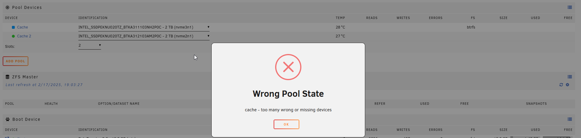

So I did as you last stated, and after selecting 1 slot, (nvme2n1) device and start the array, I get:
And the following errors:

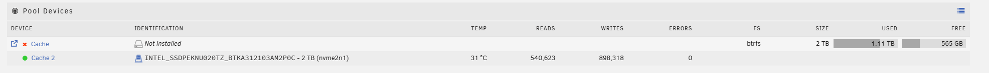

I shutdown, put the original 2TB Intel NVME back in and started up. The array was stopped and expecting cache slot 1 to be assigned. I assigned it the Intel nvme (taken offline and tested and cleared), and I get:
So it looks like I'm back where I started.
After removing the pool, maybe something else needs to be done to make it forget the old profiles before adding the single cache drive back?
Thanks!
Pool has part of the data using single profile, so it won't accept the new device, with the array running type:
btrfs balance start -dconvert=raid1,soft -mconvert=raid1,soft /mnt/cache
When that's done, stop the array, start the array, post new diags, you still may need to reimport the pool once more.
