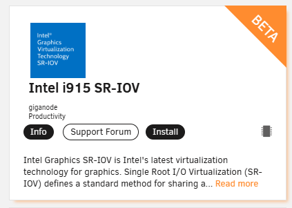

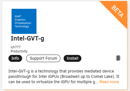

otherwise, you may need the additional driver plugin to use the igpu...
example:
*1 not both!

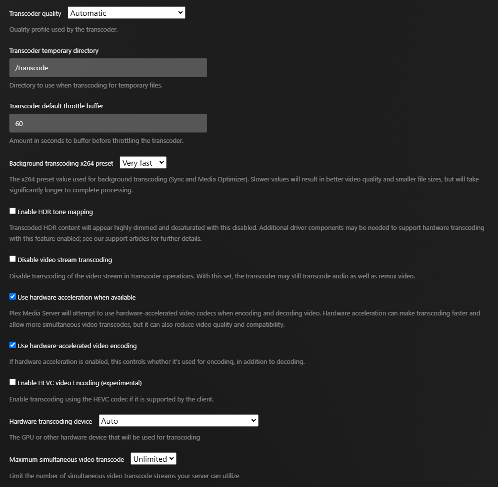

then using plex to make and edit that setting to select the intel igpu for transcode:
Current recommend transcode setting that I'm using with Linux Server Docker and plex settings:
Had to flip some settings to fix usb tuner card and use recenlty as theses things were working before teh start of teh year.
