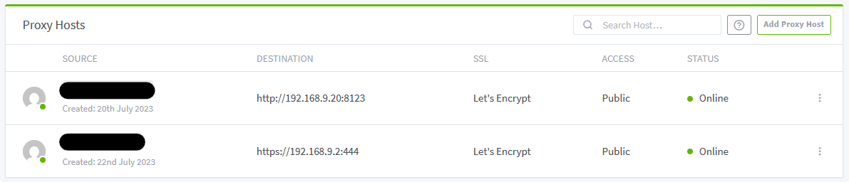

This is the configuration: - First row is the Home Assistant VM
                                      - Second row the Nextcloud Docker Container

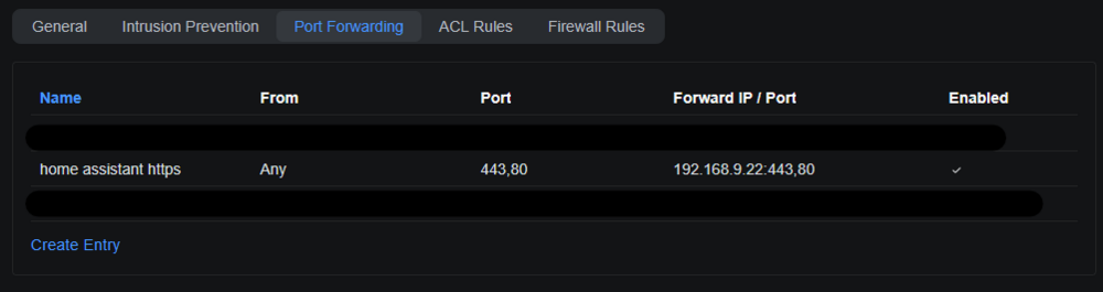

The Ubiquity Gateway is configured this way:
Taking Home Assistant VM as an example: as I mentioned above I can reach the Internal URL from LAN side (http://192.168.9.20:8123). From LAN also the External URL works (my.external.domain), but from WAN the client keeps loading with a timeout error in the end.
I'm pretty sure that the Port Forward rules are working 1. because I didn't change anything 2. because the VPN server is working correctly (Hidden forward rule).
