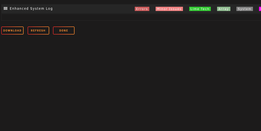

I see no syslog messages loading:

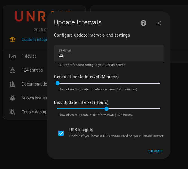

That is my Home-Assistant system using the below integration to monitor my unRAID server:
https://github.com/domalab/ha-unraid/wiki
It configured on the Home-Assistant side like this:
