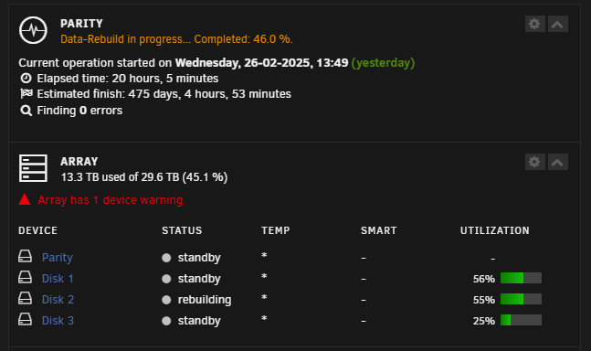

Once the server booted up again, I restarted the rebuild process. It ran stably for a while, but I found it strange that the hard drives were active without any audible write operations. Only at around 40% did the drives start making noticeable write noises, but at the same time, the data transfer speed kept dropping – from an initial 150 Mbit/s down to 50 Mbit/s until it completely stopped at 46%.

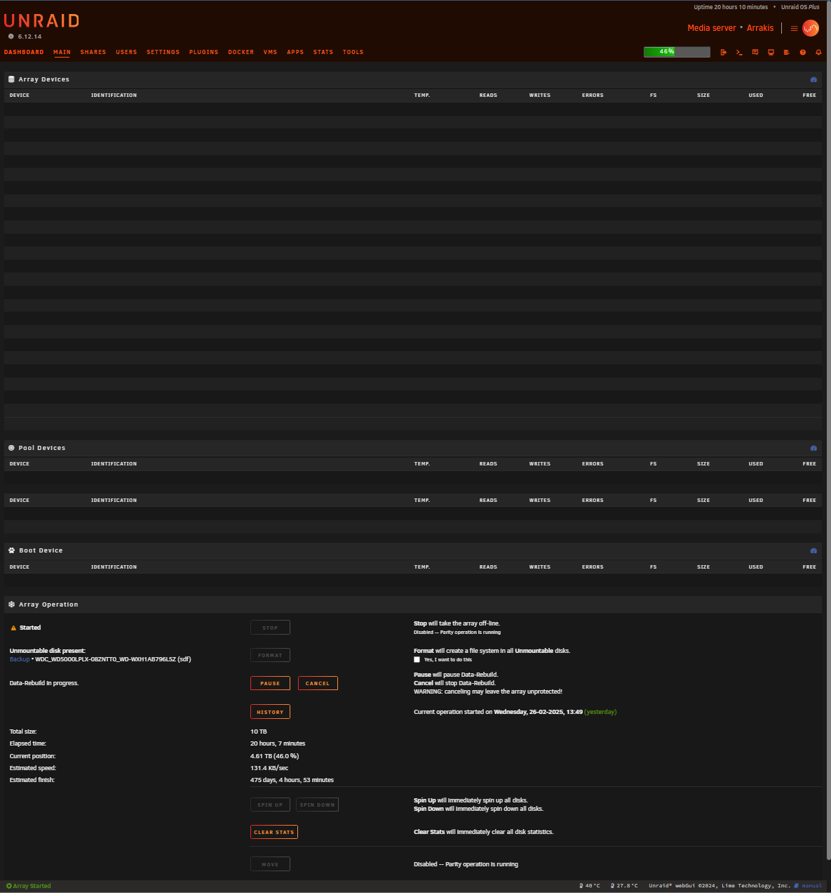

I tried pausing the process, but when I click the "Pause" button, the Unraid loading animation appears briefly, and then the button remains as "Pause" without any effect.
In the Unraid web UI under "Main," no hard drives are listed anymore. However, they are still visible in the dashboard and currently in standby mode. Through the dashboard, I can access each disk and wake them up. I ran a short SMART test on all disks, and they all passed without errors. Even though the disks audibly performed the self-test, they are still displayed as "Standby" or "Rebuilding" in the dashboard, which cannot be correct.
How can I restart the rebuild process or find out why it is stuck? Which logs should I check? I’m worried that if I restart the server now, I’ll lose all progress and get stuck in a loop.

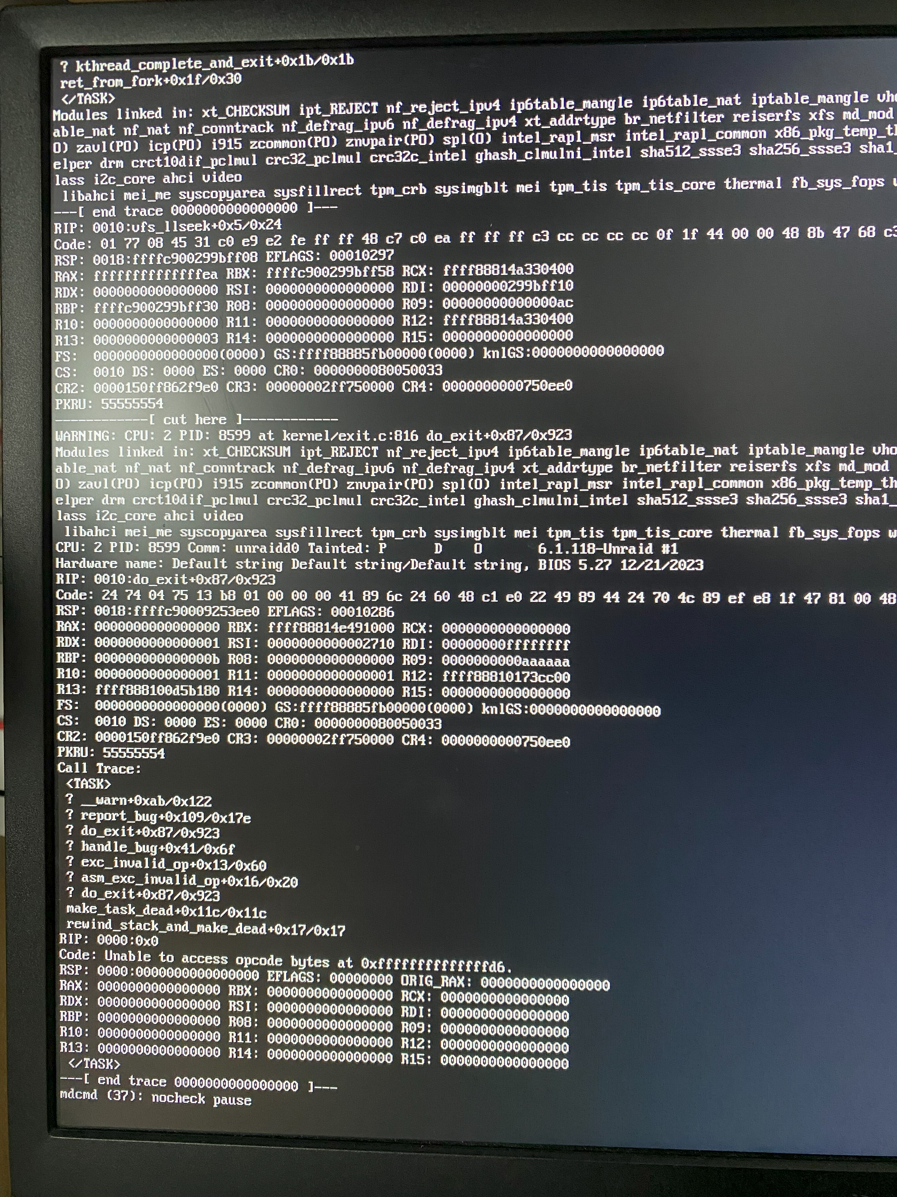

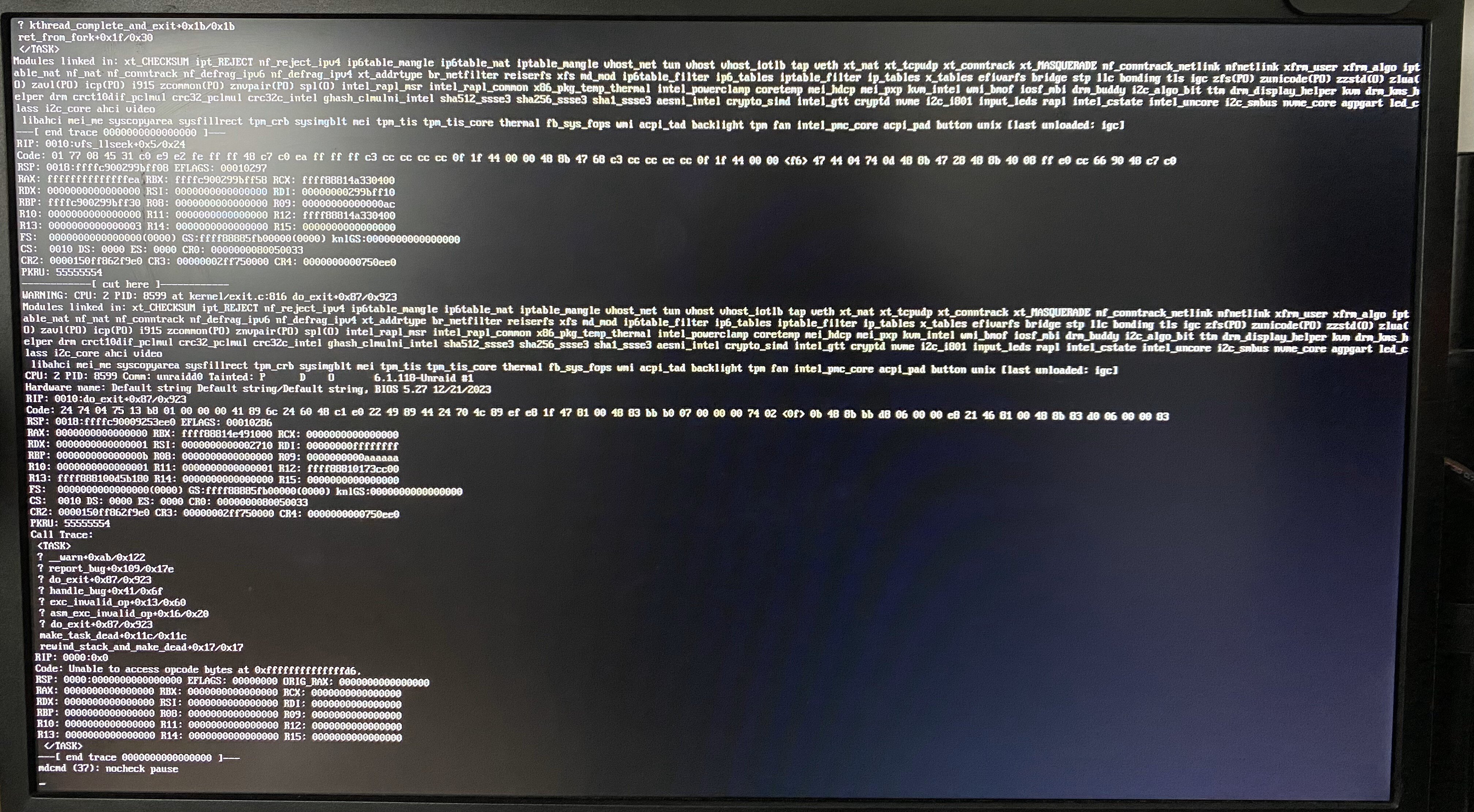

I just turned on the connected Monitor and to my surprise theres a huge Error message which I´m to dumb to read. Can anyone figure something out here? I also switched on the syslog.
IMG_20250227_101813.thumb.jpg.d676fbb9d87dd98c6727a21a2fdb52f6.jpgIMG_20250227_101713.thumb.jpg.79cbdd4f09f69a37372a151249e4e0c1.jpg

The Unraid driver crashed, this is typically a hardware issue, you will need to reboot, then recommend upgrading to 7.0.1 and trying again, if the same thing happens with the newer kernel, it's almost certainly hardware.

If there are more crashes, see if they are related to the Unraid driver (md_mod)
Feb 26 22:23:47 Arrakis kernel: ? copy_data+0x16/0x219 [md_mod]
Feb 26 22:23:47 Arrakis kernel: ? kernel_fpu_end+0x24/0x39
Feb 26 22:23:47 Arrakis kernel: ? raid5_generate_d+0xce/0x109 [md_mod]
Feb 26 22:23:47 Arrakis kernel: copy_write_data+0x48/0x8f [md_mod]
Feb 26 22:23:47 Arrakis kernel: unraidd+0xbf7/0x1140 [md_mod]
Feb 26 22:23:47 Arrakis kernel: md_thread+0xf4/0x122 [md_mod]
Feb 26 22:23:47 Arrakis kernel: ? _raw_spin_rq_lock_irqsave+0x20/0x20
Feb 26 22:23:47 Arrakis kernel: ? signal_pending+0x1d/0x1d [md_mod]
If yes, RAM would be the first suspect, CPU/board the next ones.
