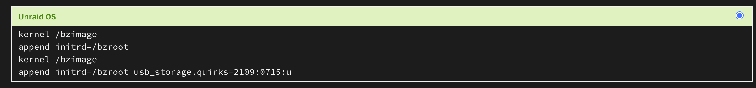

Add a quirk to syslinux.cfg, same as below but with 2109:0715:u
Then reboot and retest.

It's duplicated, just the first two lines should exist, and the quirk after /bzroot, then reboot again, and post
lsusb -t
again to confirm it's working
Thanks for clarifying that! I made the changes and rebooted the machine. I can confirm that the USB storage driver is now in use. Oh, there's it? I still have the same error as before and the disk is still disabled. Is there anything else that I can try to fix this?
