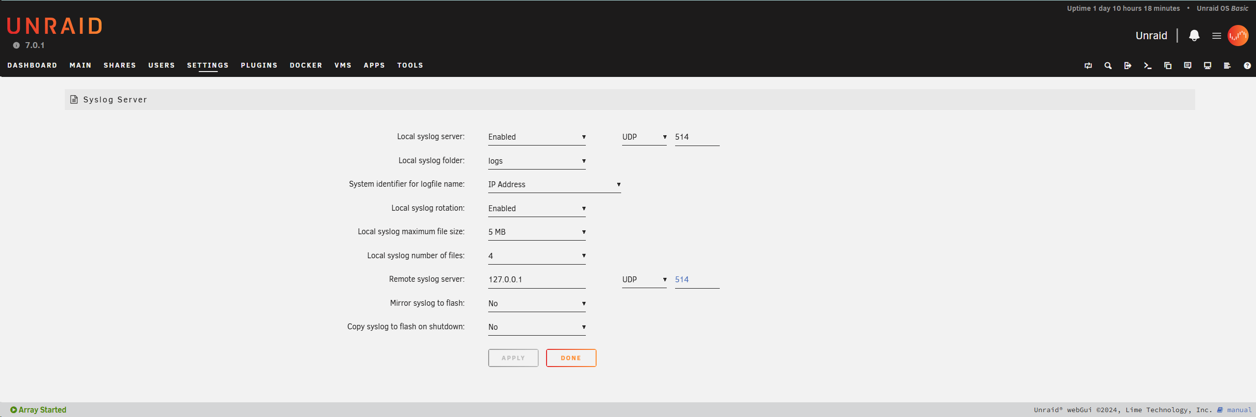

Setup syslog server.

syslog  server has been setuped few days ago
