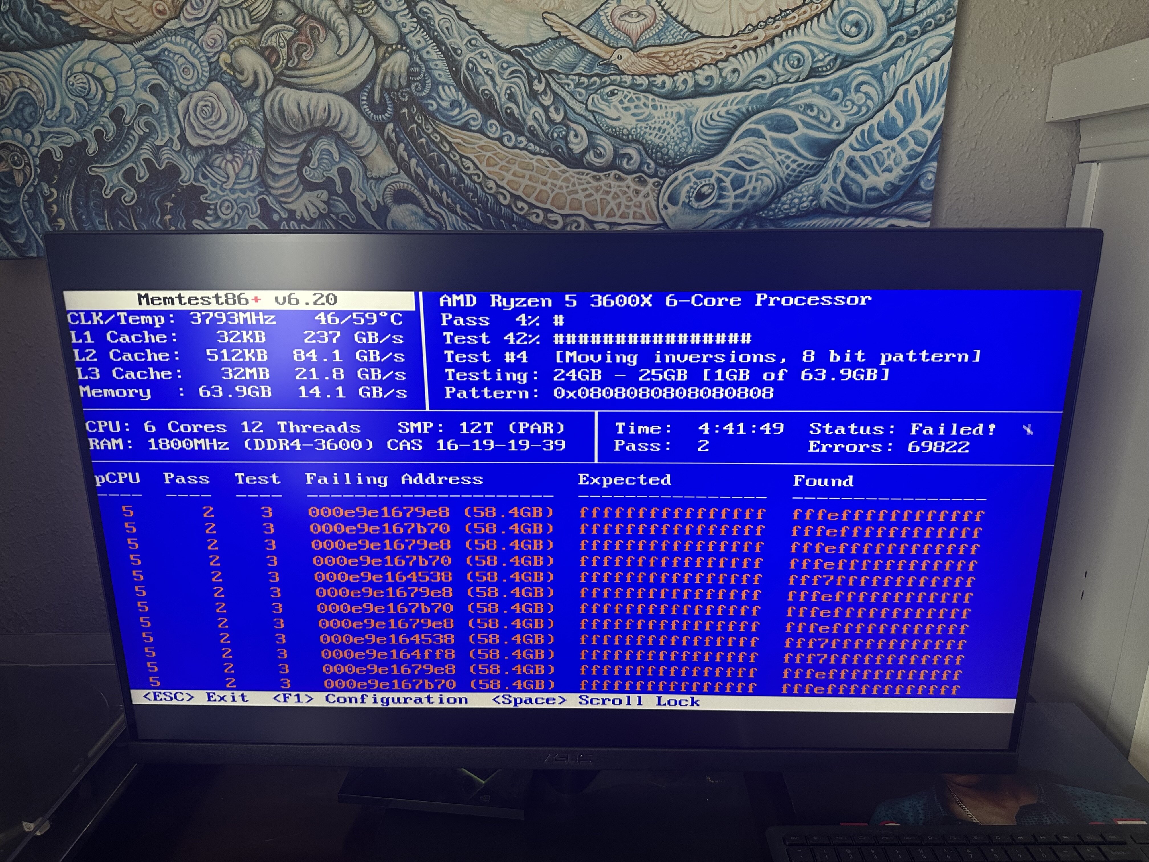

This is usually bad RAM, hopefully it hasn't done too much damage already.
Memtest is on the boot menu.
You were right…guess it’s time for new hardwareIMG_5197.thumb.jpeg.e63e5c8ea0078044a01de96bc5e74939.jpeg
You should never attempt to run any computer unless RAM is working perfectly. Everything goes through RAM, the OS and other executable code, your data, everything. The CPU can't do anything with anything until it is loaded into RAM.
