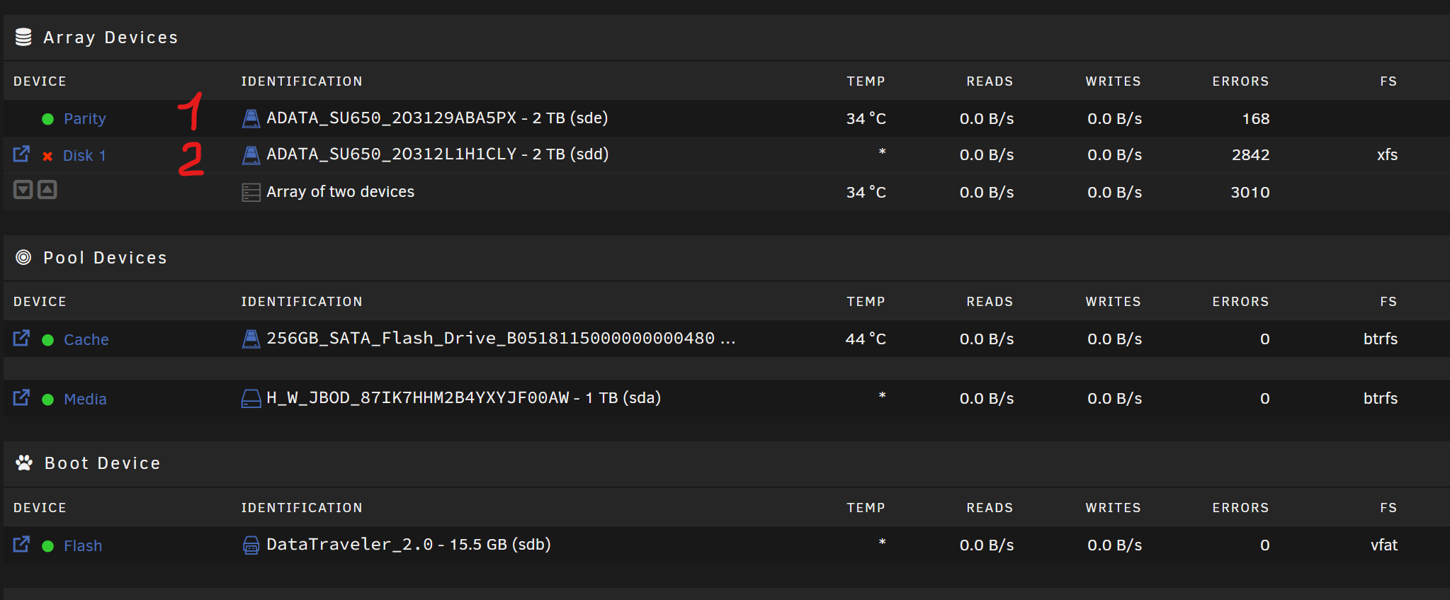

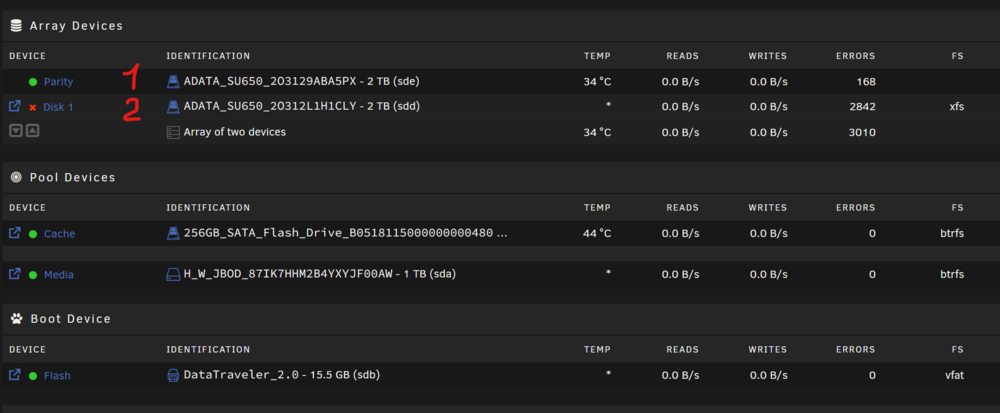

On another server the problem persists. Please refer to the attached screenshot.

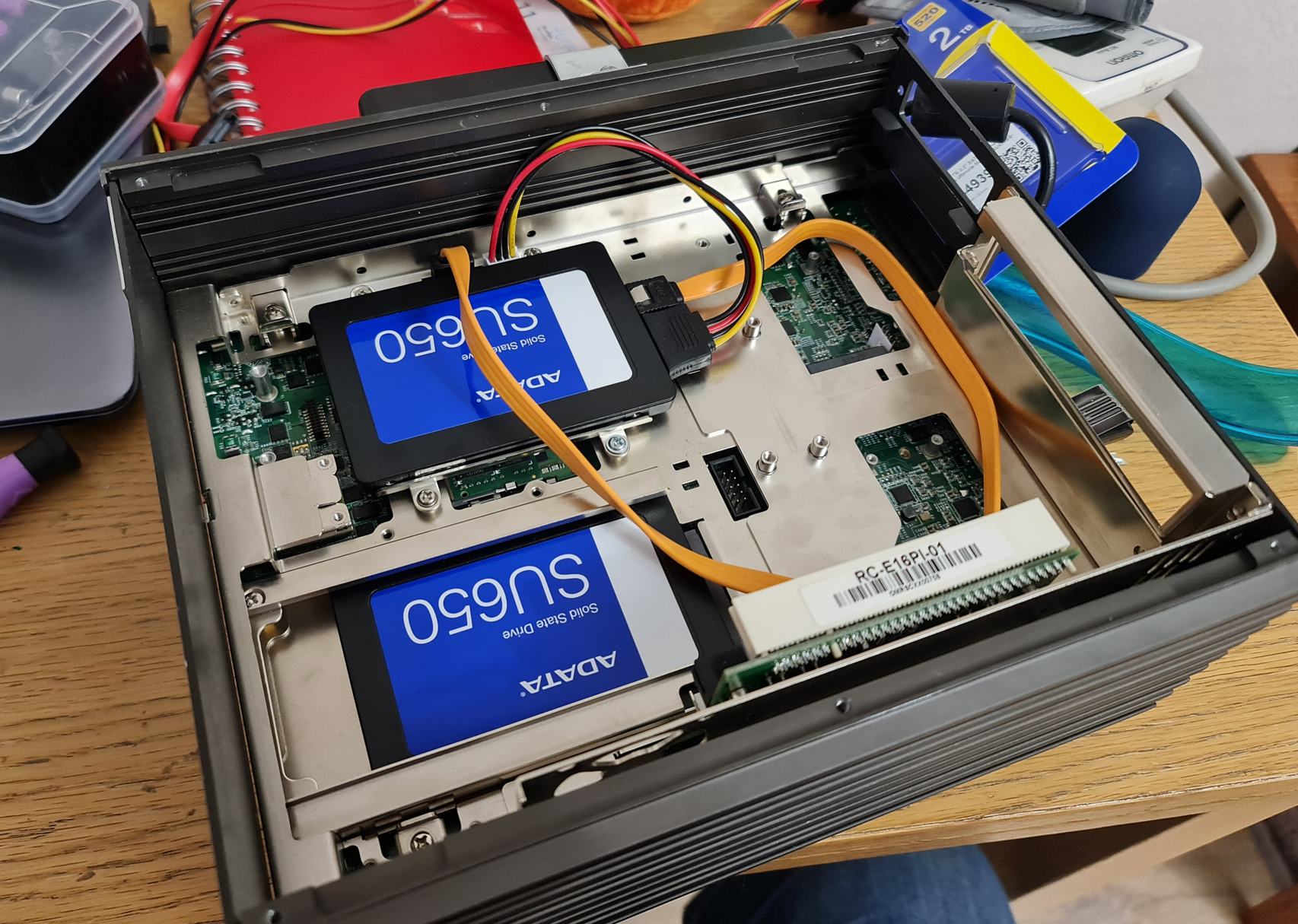

The drive marked as 1 is connected via cable, the drive marked as 2 is connected directly to the motherboard (SATA connection the same as in notebooks).
At first problems started with drive 1 - the system started parity check, showed some errors and disabled the drive after that.
That hard disk was old, so I simply bought a new one. It worked for some time (1 or 2 weeks) and at some point errors started to show up again (and on the second drive too). I had 2 new spear SSDs, so I've changed both HDDs to totally new SSDs (it was in the beginning of January).  Again they worked for a week or 2, and errors started popping up on the drive 1.
At this point I realized that the problem could be in the cable - so I changed it to a new one. And updated Unraid to 7.0.1. After that the was no errors with drive 1 for a month, but errors started happening with drive 2. Again: drive 2 is connected directly to the motherboad, I cant change a cable there.
The attached screenshot is made today: we see errors on both drives. I don't know what to do and I have a feeling that this is a software issue.

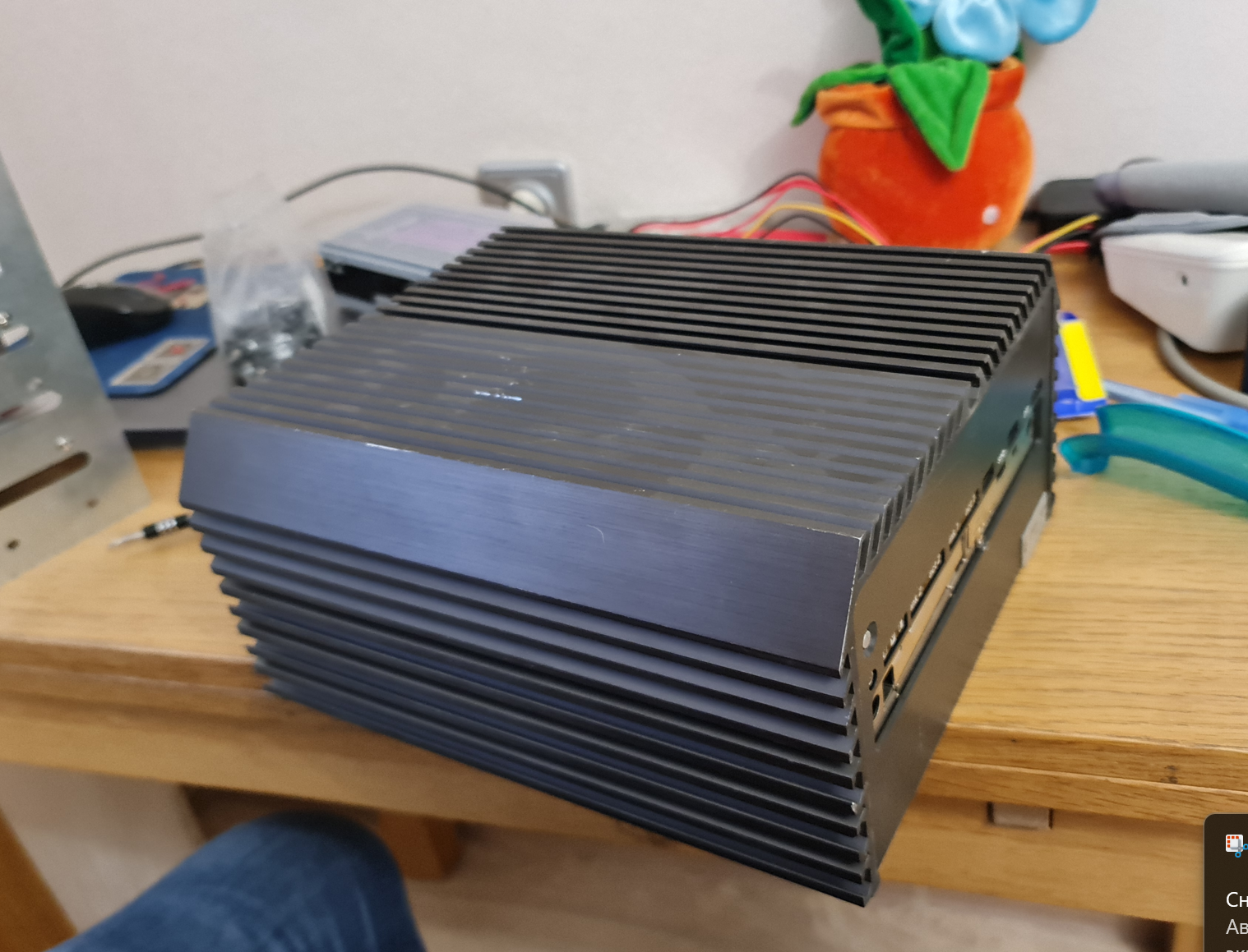

Attached: server diagnostics, logs from SSD in drive 2, a screenshot and 2 photos of troublesome server.

Looks more like a power/connection issue, replace both cables and try again.

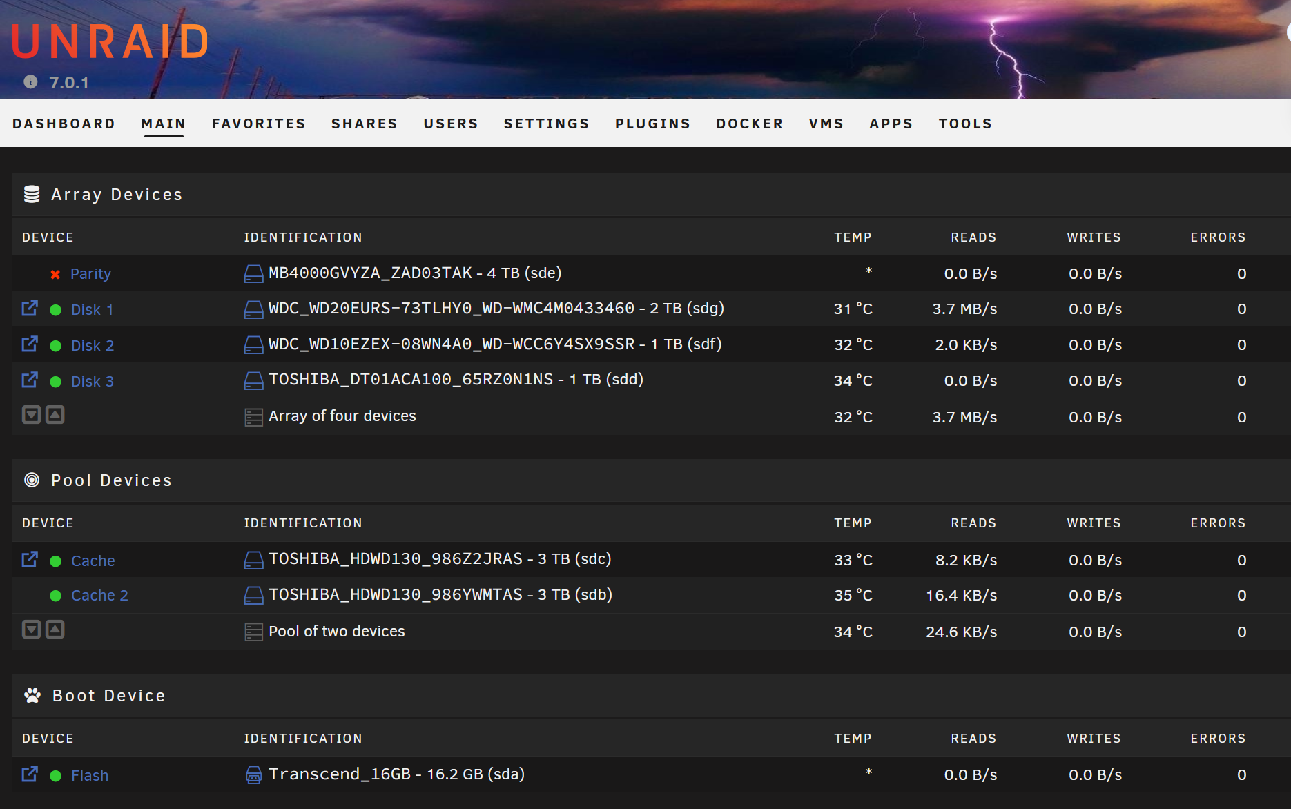

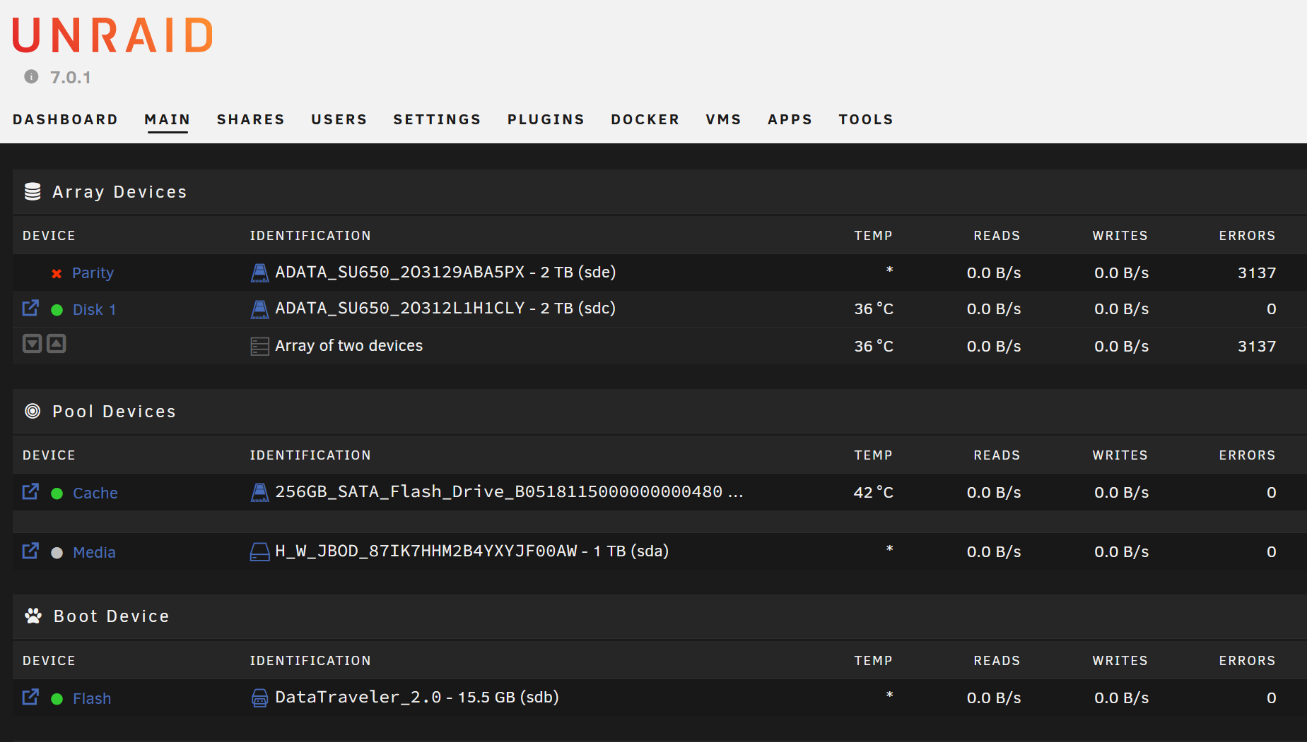

gluk-diagnostics-20250325-1250.zip alraminar-diagnostics-20250325-1250.zip
GLUK server is still showing constant ATA errors on parity, if you have already replaced both cables, you should try with a different disk, SMART for it also looks kind of strange, very few attributes.
Alraminar still looks like a power/connection issue, but again, if you have already replaced both cables try a different SSD.
