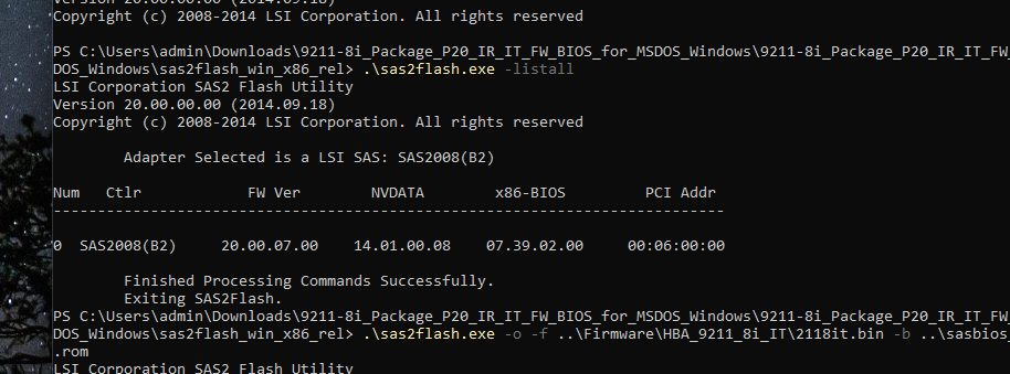

I recently purchased another HBA (same exact one, although they do look slightly different...) and installed it into PCI Express Slot 2. Only this time, the server will not boot up at all. No keyboard lights, no video output, nothing. I checked the firmware versions of each card, they are all exactly the same and are the latest versions for these cards. I removed the offending HBA and put it into my desktop, and I am able to post and see the card in device manager. The attached screenshot is of the HBA on my desktop.

Steps taken:
  1. Removed my working HBA and attempted to boot my server with only this new one, without any cables attached.
  2. Swapped the PCI slots around, with all possible configurations.
  3. Confirmed all 3 PCI express slots are working. I did this by moving the known good card to each one individually with success.
  4. Disabled Fastboot
  5. Manually set the PCI Express slots to Gen2 x8
Observations:
I noticed the green LEDs on the "bad" card are not illuminated, no matter which slot it is in. They are illuminated though when I put the card into my desktop.
Is there some sort of BIOS options causing this? What else can I try?
Thank you!
