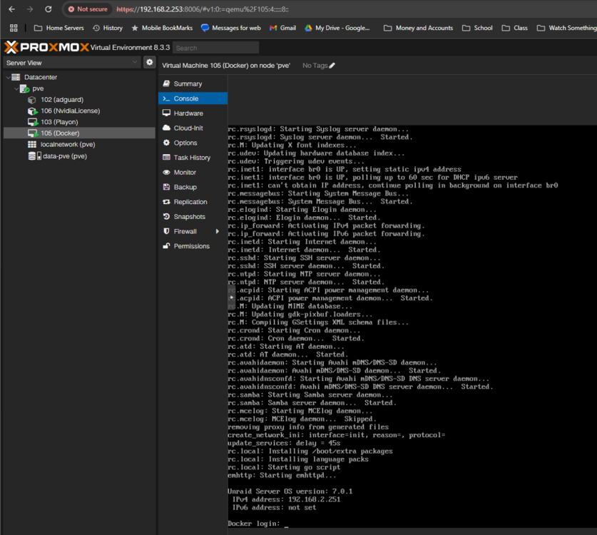

proxmox is the better hyper V. Unraid is a Nas first, Unraid excels with dockers.... So some info dump first:
There are ways to even use VGPU on consumer Hardware, splitting a gpu into portions and using it as 3d acetated across multiple host lxc/VM for additional graphical compute. (you lose physical display out....
I will always recommend proxmox for anyone using VMs. Unraids HyperV and virtual machine has gotten better with v7 it is still a mess using libvrit and xml domain configs...
https://libvirt.org/formatdomain.html
Unriad has a better single device pasthrough and vfio binding in the web ui. There's quite a bit you would need to do in proxmox to config edit and confirm. Unriad is get the iommu group separated, check a box and it will bind the device...
Proxmox Guide for Virtualizing UnRaid 7: View Promxox VM Unriad Guide:
To virtualize unriad if you go that route...
if the gpu device is vfio bound, it is hidden from the host system and can't be used on the host. I would have you look into the proxmox user scripts for LLM and run the LLM in a LXC / VM on proxmox to get better granular control on the LLM and running it as a system..

I Currently run a RDP parsec windows gaming VM... along with my unraid system under proxmox. However, the unraid system I have spun up is more for dev and testing.
Unraid has a nice web UI and decent docker support. the forum is active and people are available here to assist... that said. Everything you do in unraid can be accomplished by other means... What function does unraid server you?
