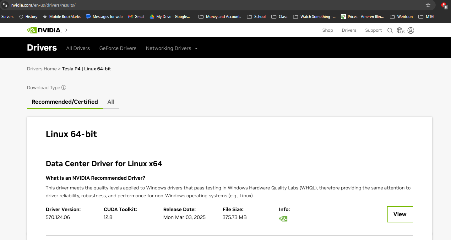

per the data provide a manual driver search give me v570.124.06 for this card on linux:
Edited by bmartino1
Data - Typo
