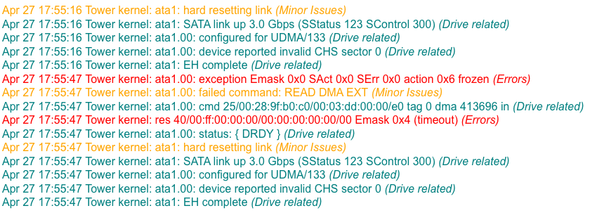

OK I've reset each of the drives in their caddies and restarted it.
Disk 1 is working at this stage.
Here's the most recent logs
The drive is still showing 'Green'.
What does 'ata1.00: exception Emask 0x0 SAct 0x0 SErr 0x0 action 0x6 frozen (Errors)' mean?

You are having problems reading from that drive...the parity drive is allowing you to watch Family Guy.  A write hasn't failed to the drive yet, which is why it is still green.

Well, if you looked at it you would see
SMART overall-health self-assessment test result: FAILED!
Drive failure expected in less than 24 hours. SAVE ALL DATA.
That is a result of this.  It has already re-allocated 2003 sectors... and the normalized value of "1" is below the failure threshold of "5"
  5 Reallocated_Sector_Ct  0x0033  001  001  005    Pre-fail  Always  FAILING_NOW 2003
Oh yes, there are two more sectors waitin to be re-allocated as well when next written
197 Current_Pending_Sector  0x0022  100  100  000    Old_age  Always      -      2
Basically, your disk has failed.
Joe L.
Man I am stupid ... I didn't even SEE that.
Thanks so SO much for helping out an old fool.
Now to read up on replacing the drive... before I ask more blatantly obvious questions!
That part is easy.
Stop the array
power down
replace the failing drive with one that is as big.  (The replacement can be bigger than the failed drive, as long as it is not bigger than your existing parity drive)
Power up.
unRAID will notice the replacement and probably not start until you check the checkbox that indicates "I'm sure"
Press "Start" and let it re-construct the data onto the replacement drive.
On older versions of unRAID, if you used the same port, you would not need to use the disk assignment page.
On newer versions, you may have use the disk assignment page to assign the replacement disk to the slot in the array tha held the failing drive.
Joe L.
all done!
Can't believe how simple it was to restore from Parity.
SO glad I went with UnRaid.
Thanks again
