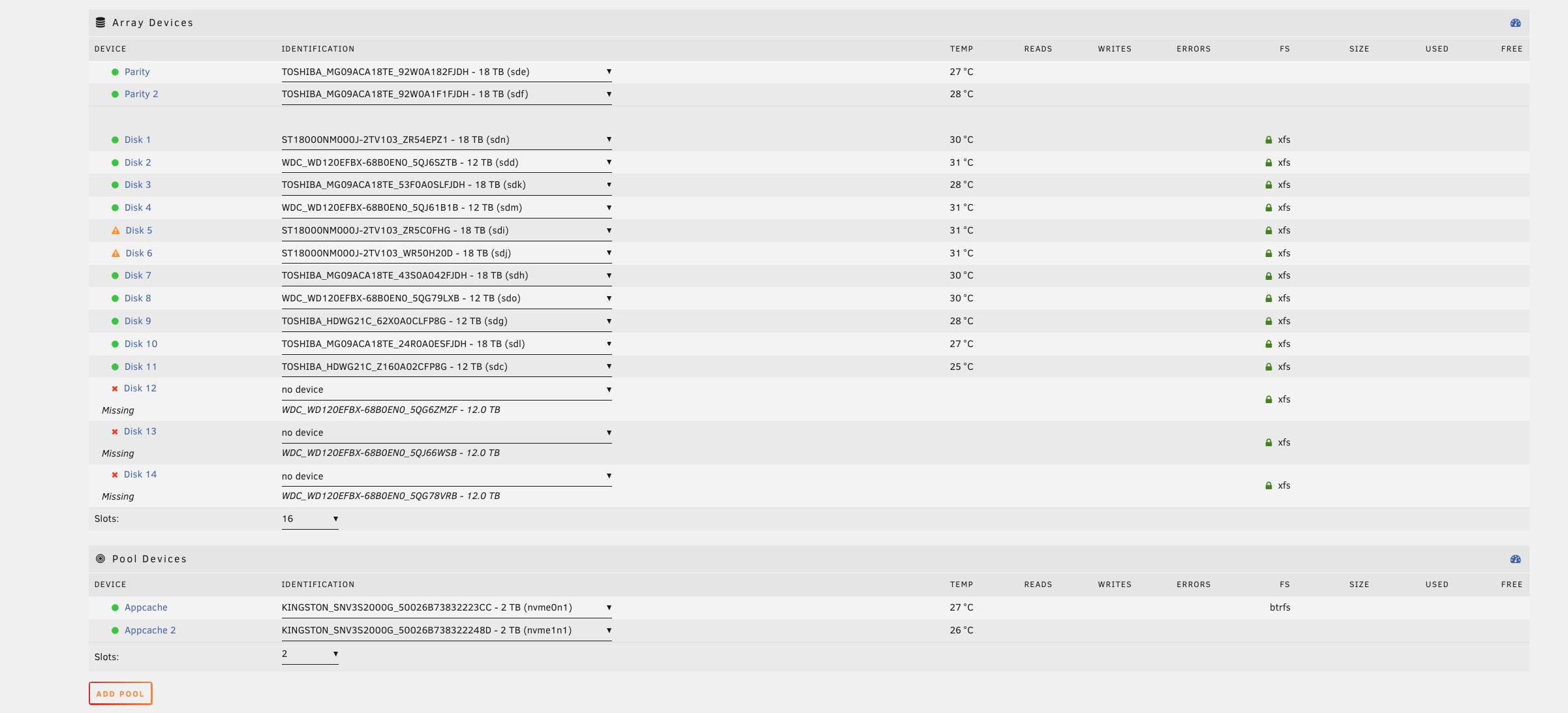

Everything working fine, today my server decides to have multiple dis failures.
So I had a power issue a day or so ago, got the "unclean shutdown" error despite NUT server doing it's thing, all disks were asleep, the cache (SSD) was the only drive in use.
Did a parity rebuild going fine, then unRaid decided 2 disks were bad, so I started to rebuild them, then it decided another disk is bad, then another, then another.
Now I have an unbelievable 4 disks bad. Crazy.
Is this a bad HBA?
Any ideas? I think Disk 7 is genuinely bad, the rest are ok.
I just stopped the server, because I am fuming right now.

You only have 2 disabled and dual parity so you should be able to start the array.
Start the array in normal (not maintenance) mode, then get Diagnostics and attach to your NEXT post in this thread.

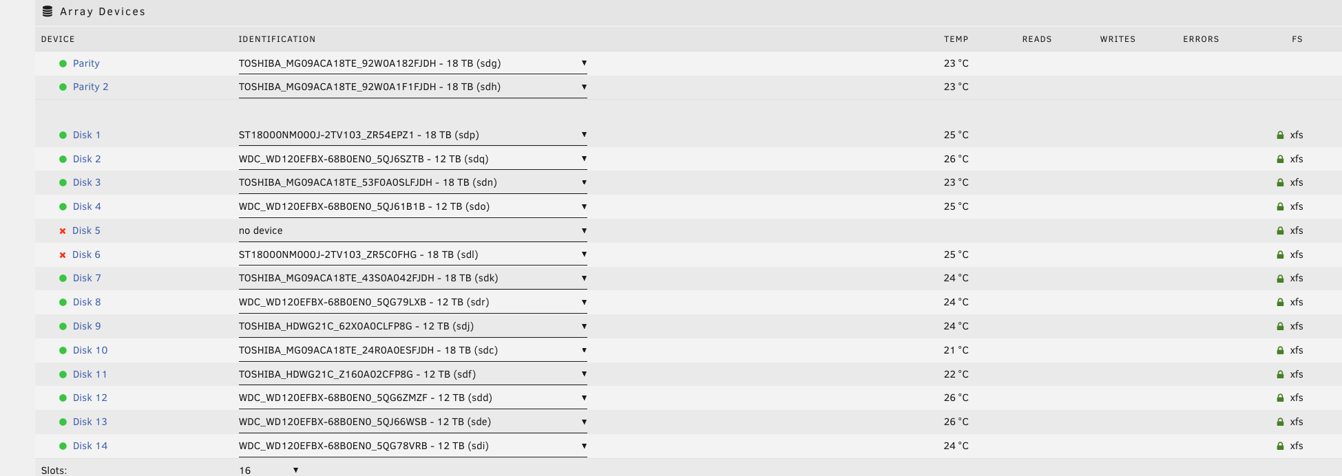

I just replaced my power supply (a great 1000w PSU with 6x SATA lanes), the disks that went AWOL are now showing, but 3 x WD 12tb are now missing. Mind boggling. It's not cables, not power, just FS errors now I would say. I want to get these drives back again before doing anything.
I did a clean shut down, so no idea why these just decided to die, as you can note, I have 6 of these WD 12tb, 3 died.
Jesus this new PSU id noisy.
I think I'm inn the territory;

Well that was exciting. So what happened was that when replacing the power supply 3 WD drives had their fuses blown (apparently quite a common thing). I brought them into my friendly Polish electronics repair shop and they brought them back to life by replacing the barely visible SMD fuses.
Popped them back into the server, they mounted without issue.
The next problem was the two drives I mistakenly started to rebuild (before I realised the power supply was dying), the repair finished and they were both marked "unmountable". I followed the Disk Repair Procedure using the GUI and they both had a "zero log" error. They refused to mount, so I just cleared the log with the GUI and ran another file check, which both drives passed.
All back up and running. I'm going to swap those WD's out for 3 new Toshiba 18Tb drives in the next few days and finally power up the Zimacube Pro backup box I bought, which I am going to install unRaid onto.
unRaid really is a sublime piece of software that really keep data safe no matter what we throw at it. I learned a big lesson, relax and analyse the problem before pushing buttons.
