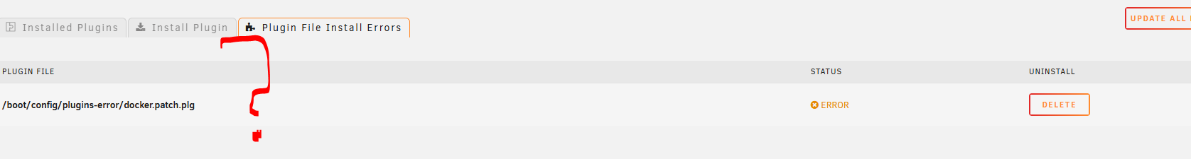

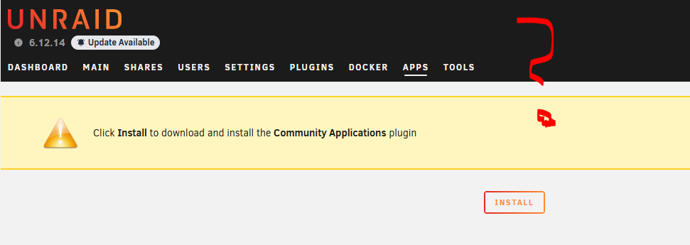

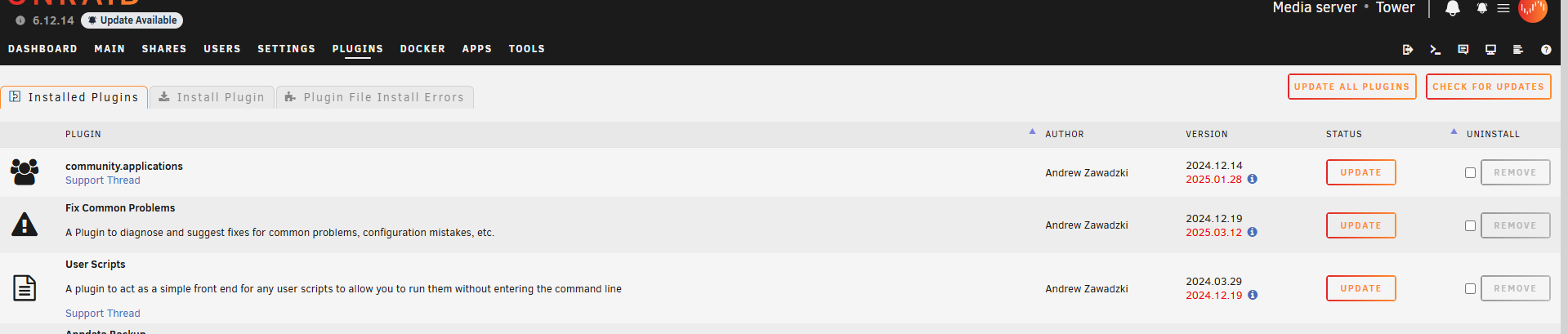

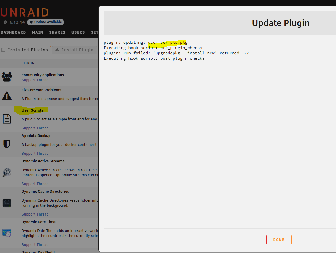

Cannot update 3 plugins AND Community Applications has disappered
I have never seen this before and I do not want to restore from backup if I do not have to. Anybody know if this is a known issue and how to fix it?

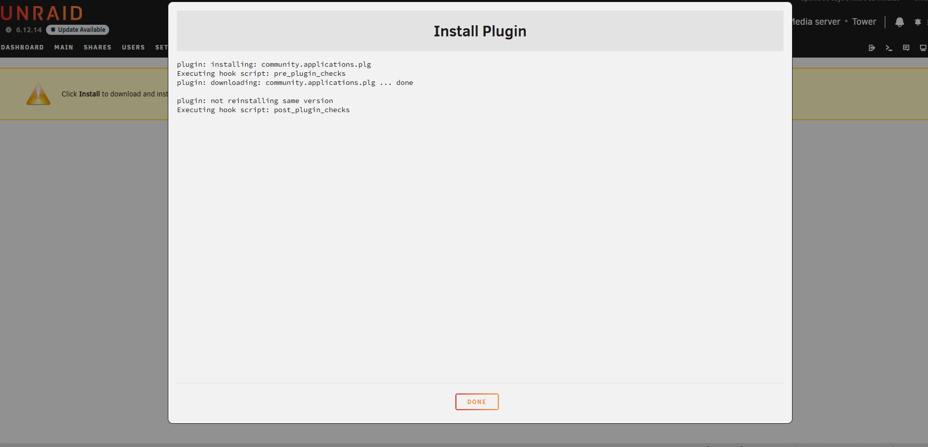

Maybe corruption.
Might be the best idea.
You could try deleting Community Applications .plg file and its folder from config/plugins on the flash drive to force it to get them new.

Ummmmmmmm..........I restarted and everything works now.
