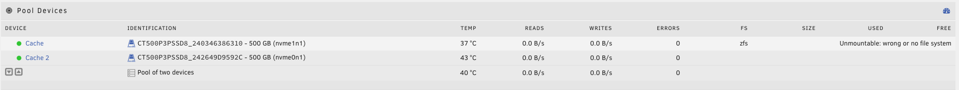

After that I can start the array, but obviously I can't access any data on the cache pool
The GUI will show the pool unmountable, but the data should still be under /mnt/cache, copy anything important to the array or another pool/device and then re-format the pool

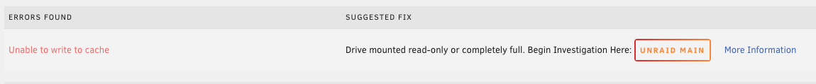

I tried both methods, but then started seeing this in the syslog when I tried to re-format, and the gui still showed `Unmountable: wrong or no file system`. Fix common problems was also suggesting the cache pool is still mounted read-only. When I tried:
