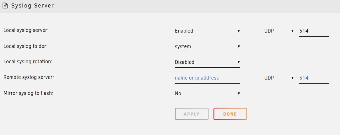

Ahhh.. Appreciate your clarification and apologies for my ignorance on a lot of this. These are the current settings.
Syslog server receives syslogs and stores them. It can receive them from other servers, or it can receive them from itself. Put localhost in the Remote syslog server field.
Wow, I cant believe I overlooked that. Thank you. Added.
