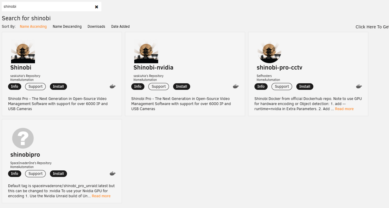

If looking for general NVR options with ease of use a paid software stack may be better...
https://shinobi.video/pro
or
https://blueirissoftware.com/
windows VM and other as they all attempt to connect to the camera's stream... storing data on a unraid samba/nfs share...
As a lot of the free stuff has been incorporated in to others works, and there's not that many free nvr out there...

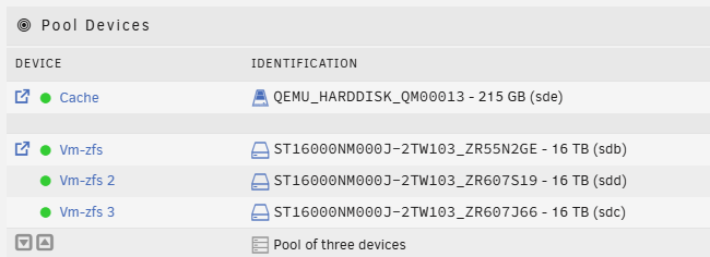

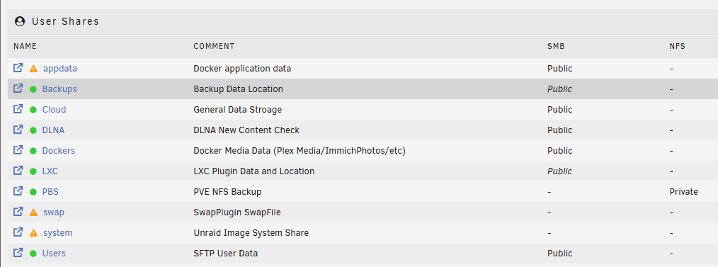

This still comes down to how your system has the disk handled and how you tell the docker path to be located at...
Example.
I run Unraid v7 no d1 array no parity.
I have a BTRFS single pool device cache
I have 3 disk in a zfs raidz1 array.
In your case your adding a btrfs 1TB ssd as a single disk pool which is fine. Usually you ant 2 disk for a mirror for redundancy. Or High capacity disk as Video especial 4k quality and continuous stream takes up alot of disk space...
So for my plex example As i use the cache appdata default share alone:
and I'm using the default path for cache... This more or less helps unraid default paths based on templates...
When in truth, you can tell the docker via the template or docker options to store data at different locations..
as My main plex docker is set to my zfs array including its database and large video media files...

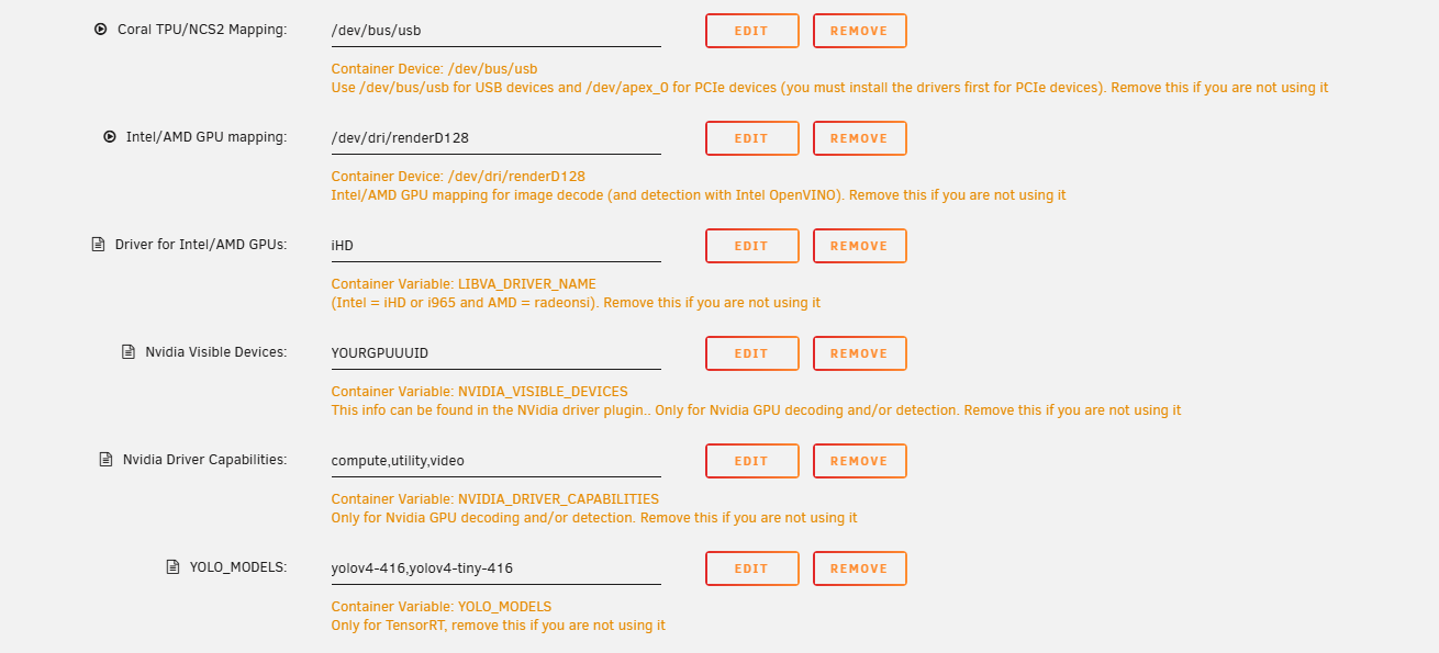

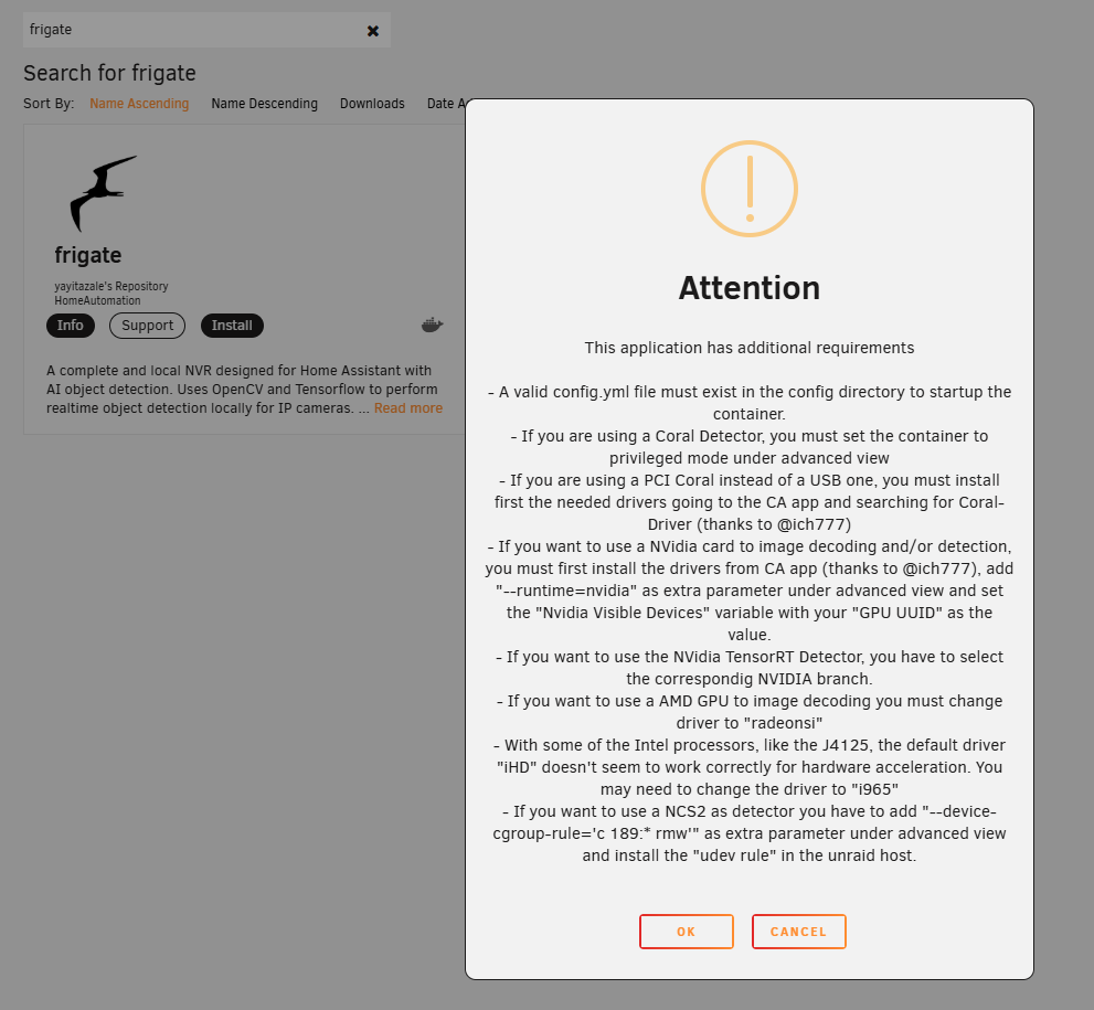

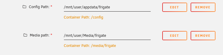

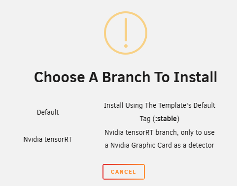

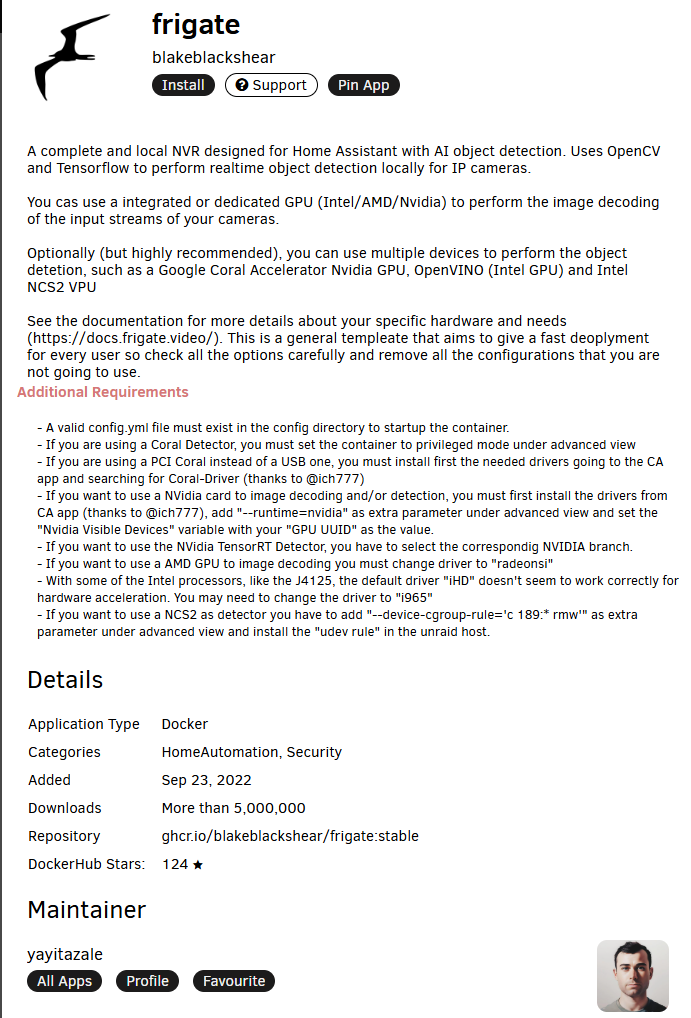

so when you install frigate:
chose default:
and tell the template where you want the files to be stored at:
you will see other options as noted in the attention and overview and support forum...

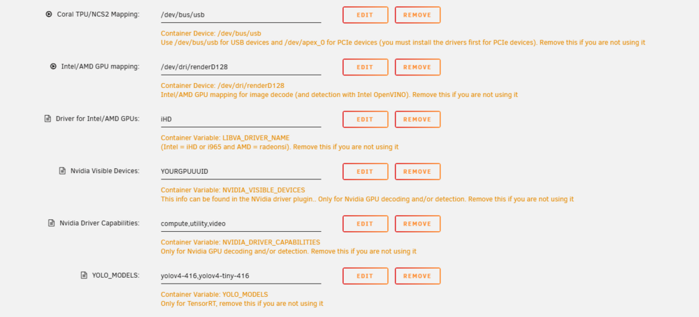

in the template is where we can set up devices that frigate will have access too...

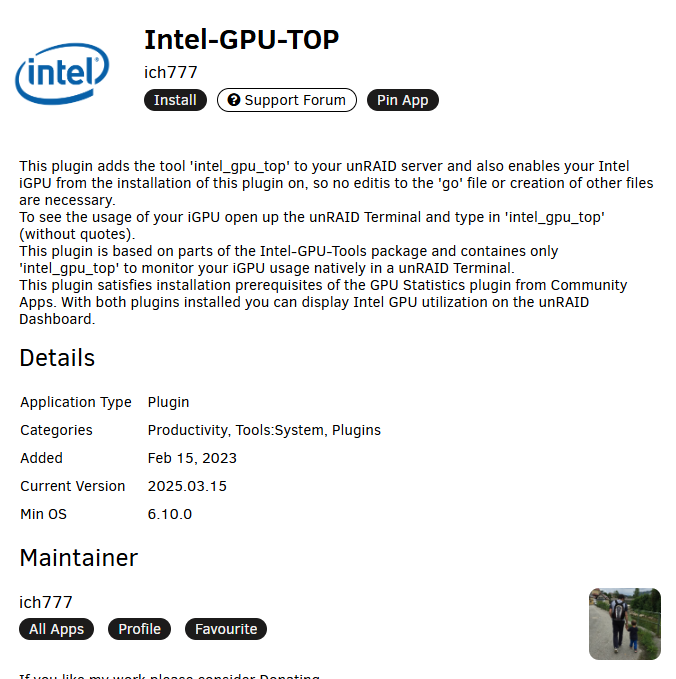

here is where the unraid plugin for the igpu graphics card is installed In your case into itop...
Based on your i7-7700 info at top I think you need this plugin installed:
Install beforehand!
and Maybe this one:
more info on the forum here:

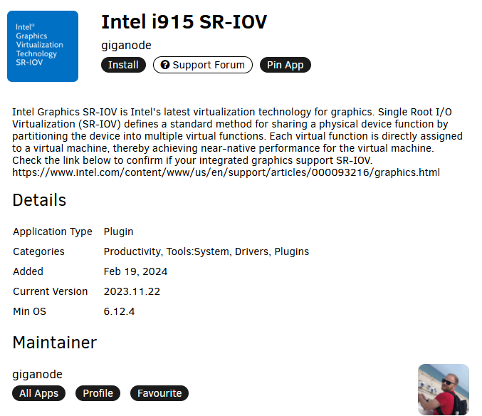

Per ICH777 witheth i915 sriov driver install as well. With some of the Intel processors, like the J4125, the default driver "iHD" doesn't seem to work correctly for hardware acceleration. You may need to change the driver to "i965" esentail teling modprobe to load teh older driver...
what is your settings for:
can you console in teh docker termainl and run ls /dev/dri and do you see a renderd128 folder?
