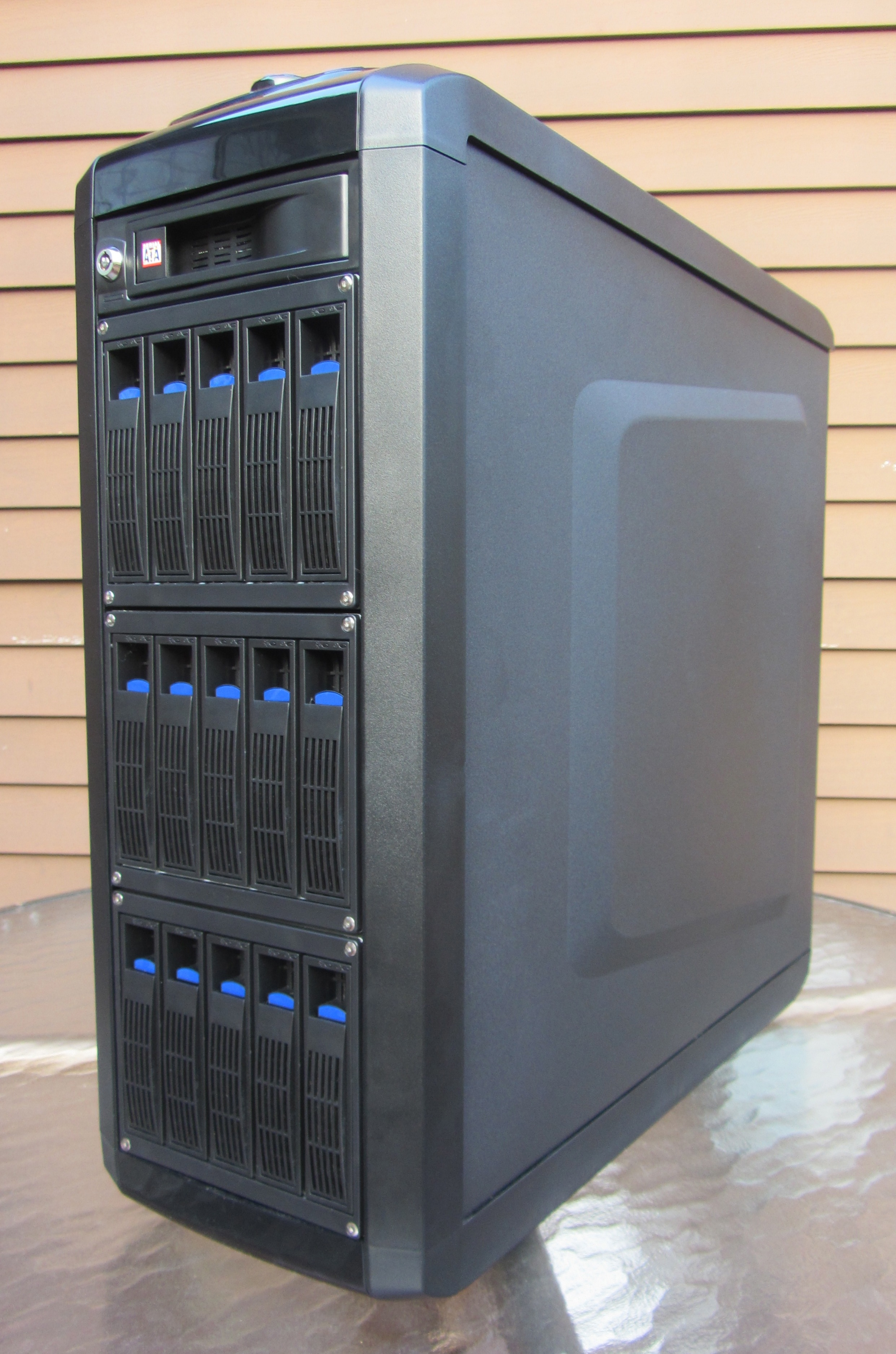

I'm not sure. I have a 20 drive NAS, built by Greenleaf Technology. 4 Drive Cages. SuiperMicro mobo. Tons of SATA cables to MOBO. Dual PCI Sata expansion cards. NAS has been running without issue for years. I've tried moving the drive to each of the 4 cages, and same problem.
Edited by newoski
So when you say
19 minutes ago, newoski said:
which bay I put the drive into
Does that actually require you to touch the SATA cables?
No, I just open the vertical bay door on the front, pull out the tray, screw in the drive and slide it back in
This isn't my exact server, but it's nearly identical and functionally the same
OK, the drive cages have backplanes.
