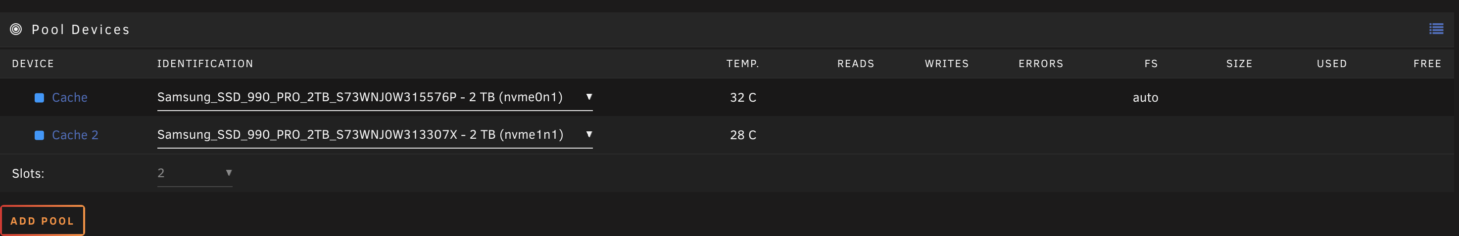

On the step where I re-add the devices and start the array. Should I change the FS from "auto" to "btrfs" since my cache pool was originally a shared-non-raid pool of 4TB total?Screenshot2025-04-11at10_14_59AM.thumb.png.45f09d0767c811b4a5c91f7028e45690.png
Leave it in auto
