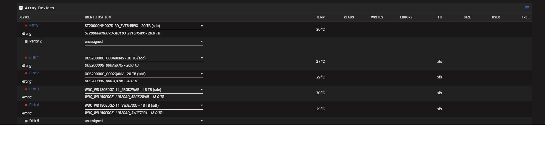

I see all the drives with correct serial numbers and assign each drive to the same position as the old drive.
Each Disk shows as "Wrong" and the "Start Array" option is not enabled.

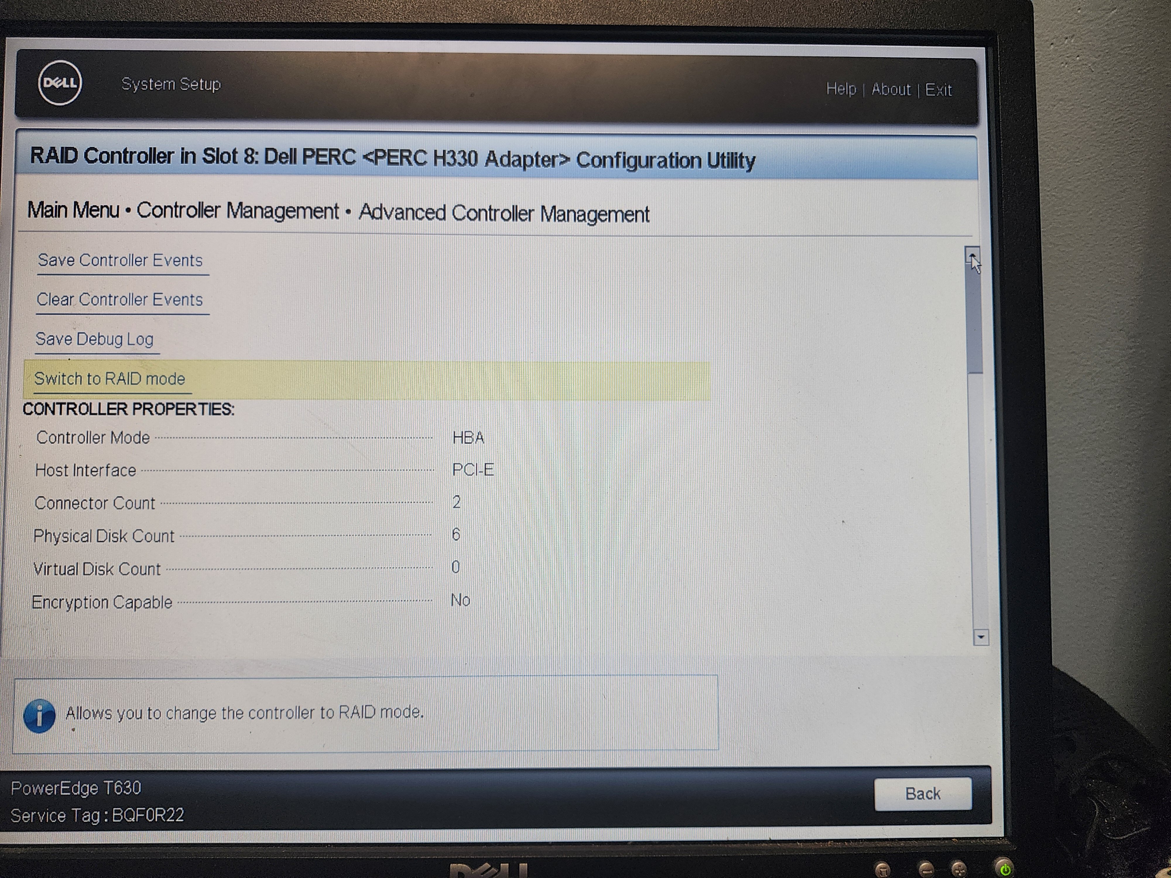

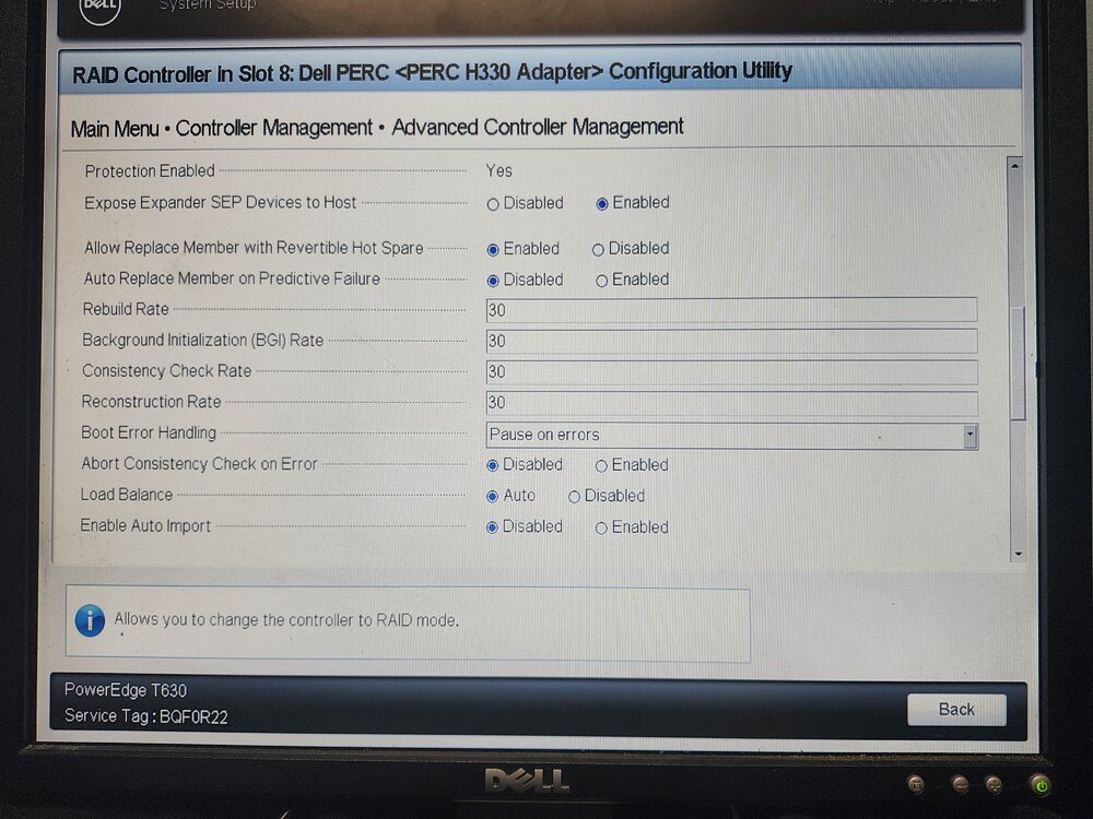

New system has a PERC H330 and I double checked that it is in HBA Mode from Dell's System Setup.
Are there issues with UnRaid and the H330?

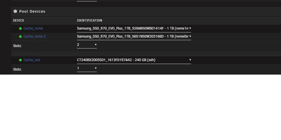

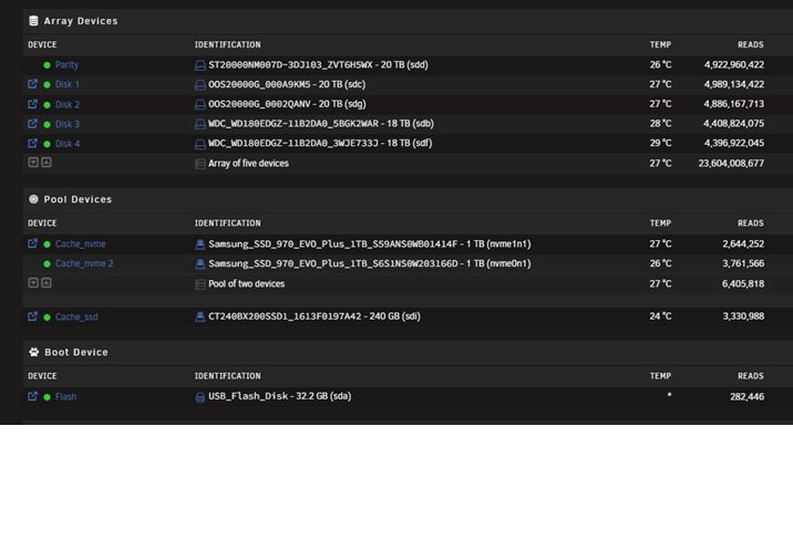

Here is old and new configs.

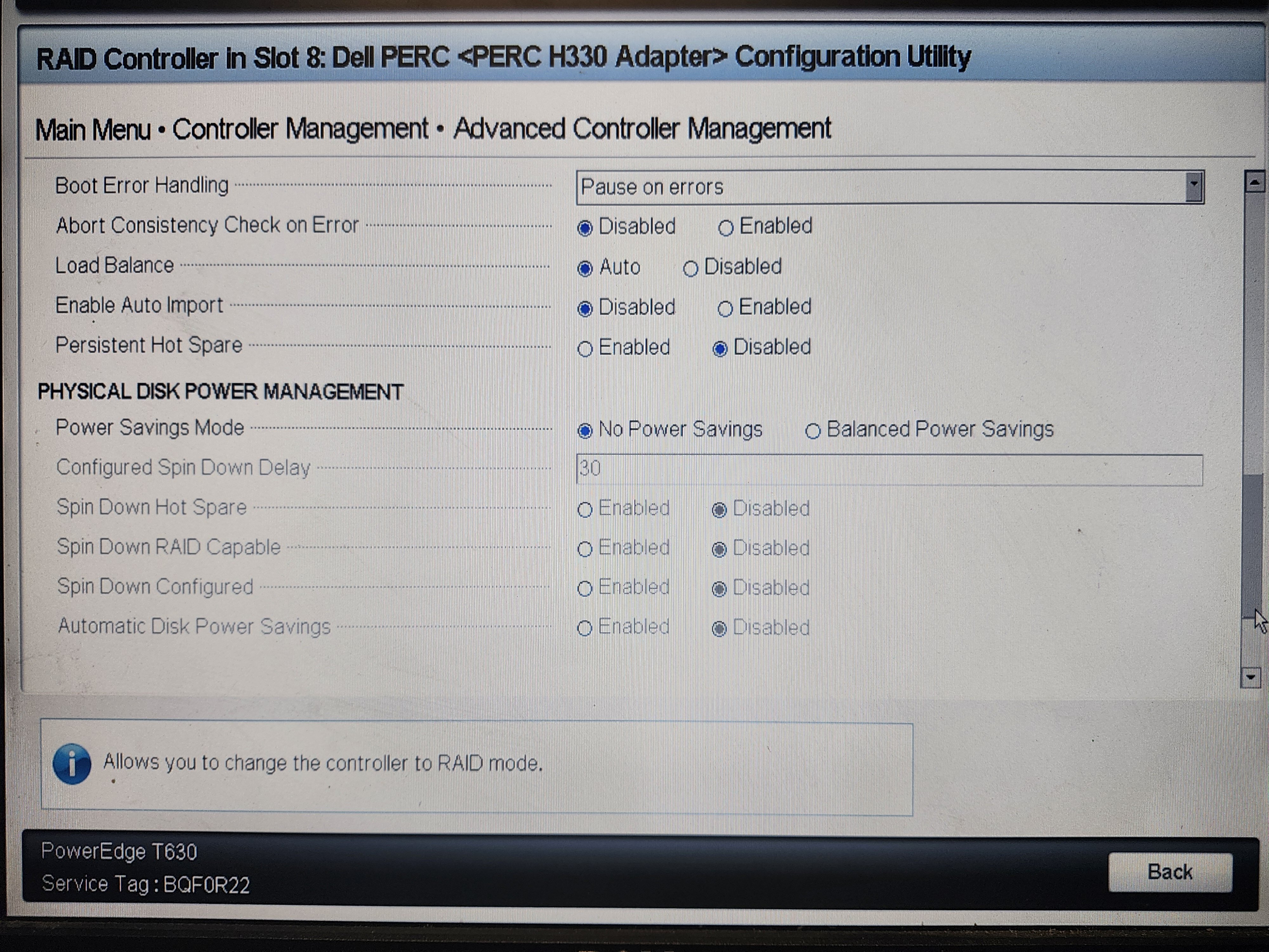

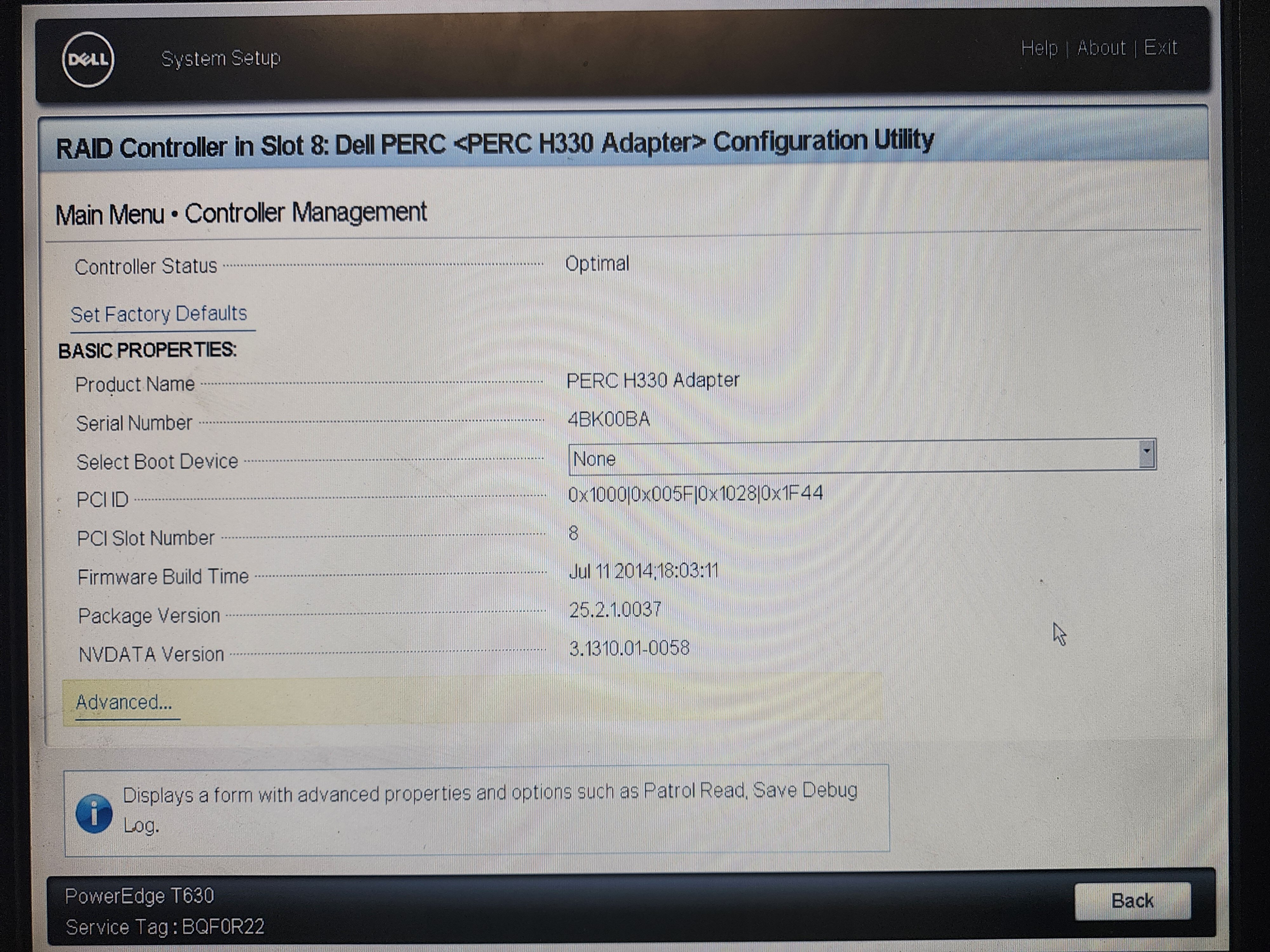

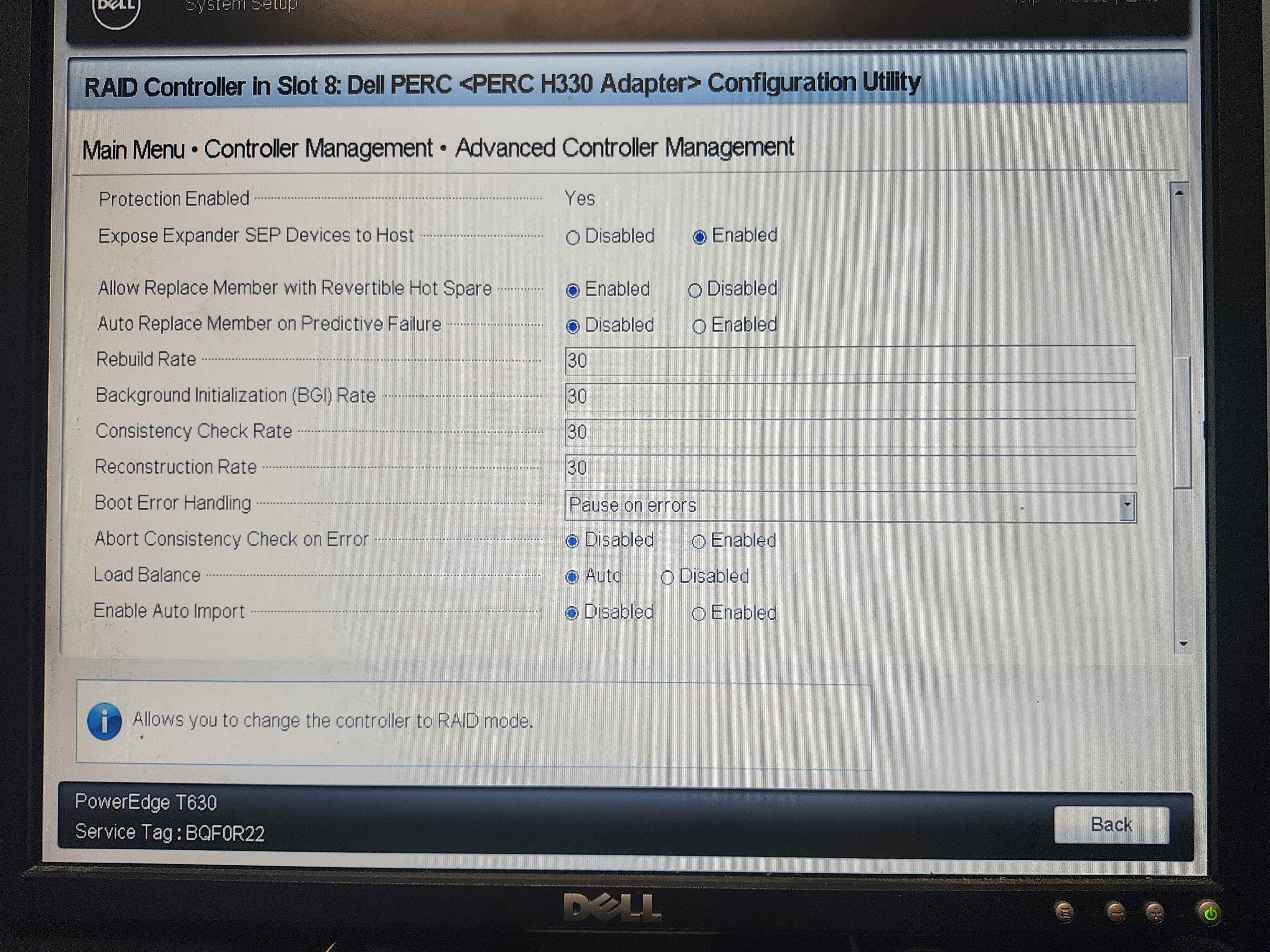

Here are the PERC Settings from BIOS:
All good now!  PERC Drivers were outdated and i missed that.
Updated to latest version and all is well.
