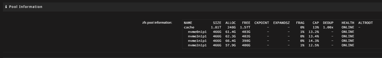

Thanks for the quick response. Yes, I used striped pool since I planned with much more space needed than it actually turned out. The drives I want to remove are nvme0n1p1 (cache 1) and nvme1n1p1 (cache 3). The two on the adapter card that I use. But that's more a QOL thing, since I have no problem switching the SSDs to different slots if it's better to remove caches 3 and 4 and keep 1 and 2 for example.
The cache pool in its current configuration contains 4x the same 500Gb Crucial SSDs and is currently utilized with around 250GB of data striped pretty evenly on all 4 drives with between 58GB to 66 GB per drive.
If it's possible to remove the drives without losing any data, I'd welcome your instructions very much. Thanks a lot for that offer.

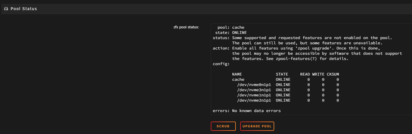

Oh, something that might be worth mentioning, I haven't upgraded the pool to a zpool. Do you have any advice on if I should do it before or not?
That doesn't matter for this, to remove a device, with the array running type:
