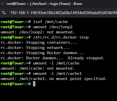

Tried lsof /mnt/cache and unmounting /dev/loop2 first as these seemed to be problematic in other posts with this issue. Docker is already stopped as shown and VM's are disabled on my Unraid server.

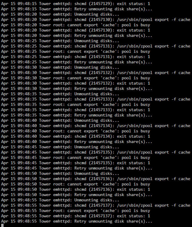

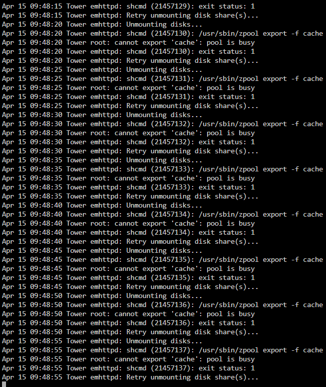

In the logs though it clearly shows that it is the cache holding it up though which makes no sense to me?

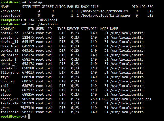

I'm only seeing directories from the flash memory storage mounted from my understanding running losetup should show everything mounted.
