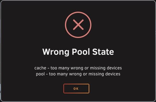

  • Attempted to start the array in maintenance mode, but I got an error:
    "cache - too many wrong or missing devices"

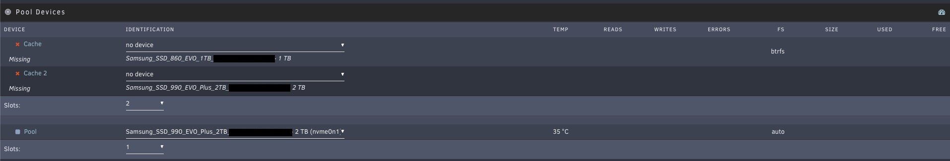

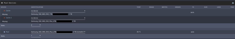

I created a new pool. But the old pool os still there. Indicating missing devices. I will not be able to start the array unless they are assigned. Now I have 2 pools giving me the same error.
I would like to delete both pools, add one new pool and put the new 2TB nvme drive into it.
I figured it out after reading how to delete a pool.. I did not realize I could click the pool name and then remove the pool.. That really feels like a very rookie mistake.
