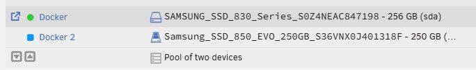

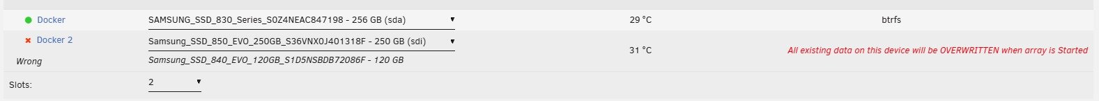

The second disk shows as New Device when the Array is started and as Wrong when stopped. (see images)
It claims all existing data on this device will be overwritten when the array is started, but simply nothing happens.
The old 120gb disk is also shown like Unraid still expects that drive

Click the first device from the docker pool, then "remove pool"
Back on main, create a new pool with the same name and 2 slots
assign both pool devices (sda and sdi), leave the filesystem set to auto
start the array to import the pool
That shouild do it.
