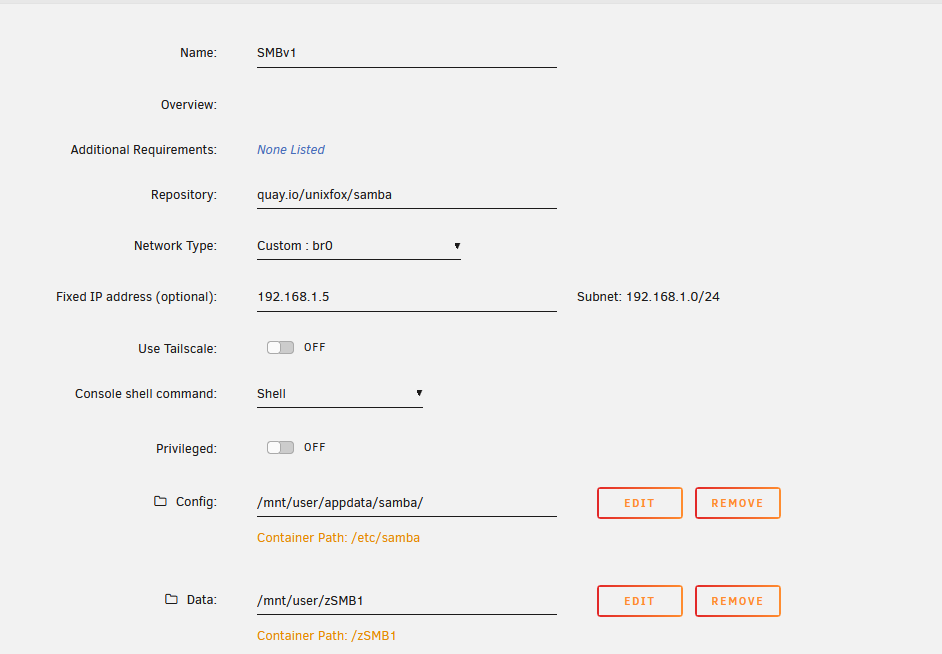

You need a new share, I called it SMBv1 and created it like they did in the forum post created in UnRaid.
You need a directory /mnt/user/appdata/samba
You need to create a smb.conf file there that has this in it under the /mnt/user/appdata/samba.  I know there are ways to pass this stuff as you build the container, but I was struggling.  So what we will do is inject this file into the container as a volume and mount this path in the container as /etc/samba.  I set it up with zero security.  No username, nothing.  So your family jewels are showing.  Also why it is in it's own share.  Also, OPL has zero log data other than error codes and I didn't want to complicate it with user accounts.

In UnRaid under docker this is how I created my container.  I used 192.168.1.5 for my ip address of the container.  You'll have to adjust that to your network.  Other than that  you can see under Config and Data how it should look when you add paths.  Please see the other forum post if you need help in that OP did a great job explaining it.
