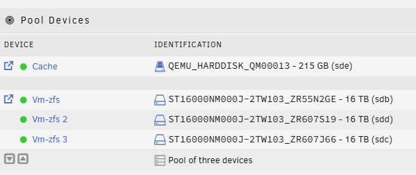

In example snapshots. I would use and prioritizes zfs and the built-in zfs feature.
-This would mean you would need a min of 3 disk the same size to make a pool disk array to use zfs.
With unraid 7 you can ditch the array and use pool only as example above.
cache disk used for unraid system .img files for dockers and vms and potentaily other plugins..

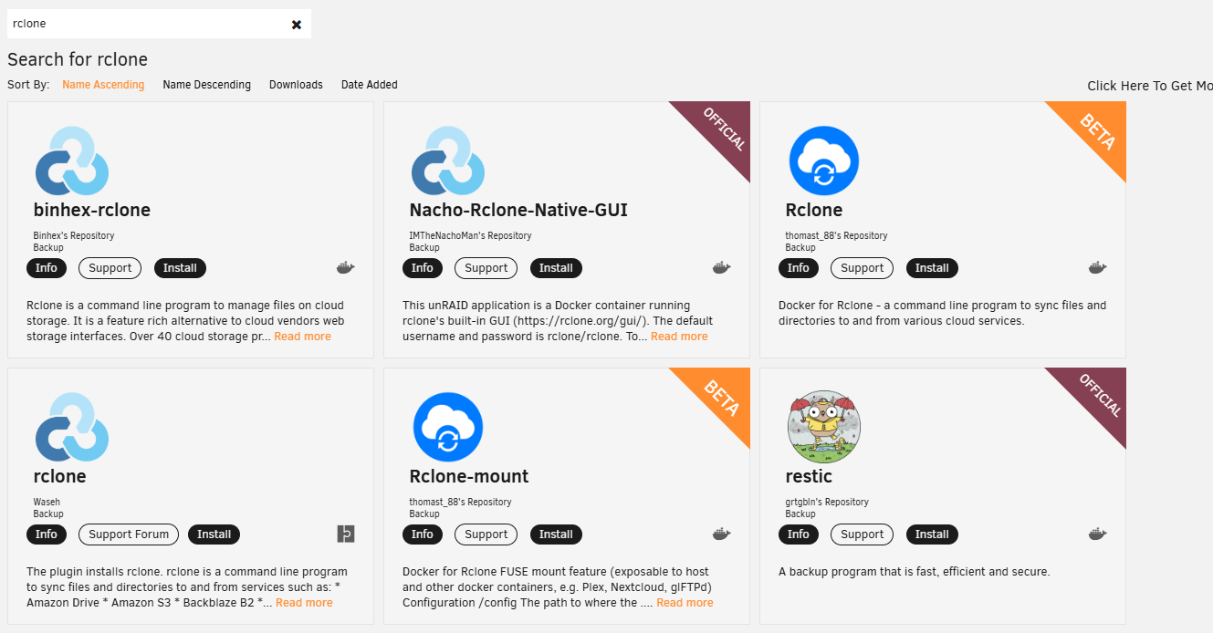

The main plugin/docker setup your looking at is rclone...
Then you may need additional services for webdav / web file / sftp/ftp access to connect to your unraid system...
I would use the rclone Washe plugin.
-Other options exist in the CA (sythinthing, seafile....)

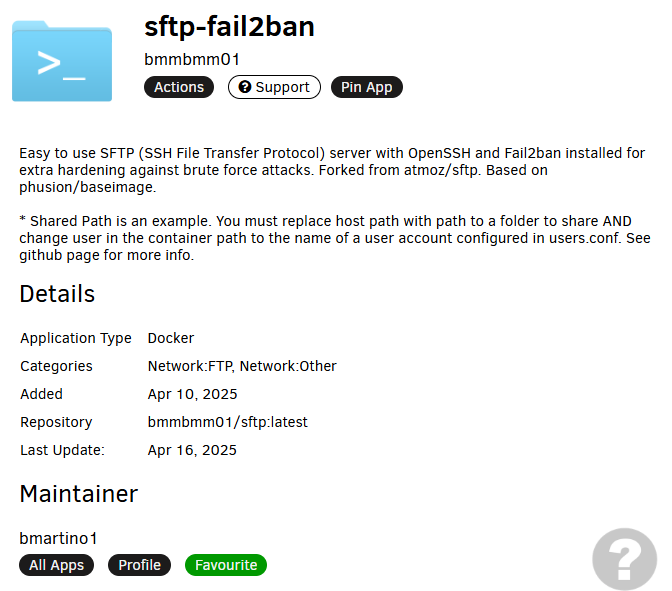

SFTP/FTP :
SFTP-Fail2ban Docker

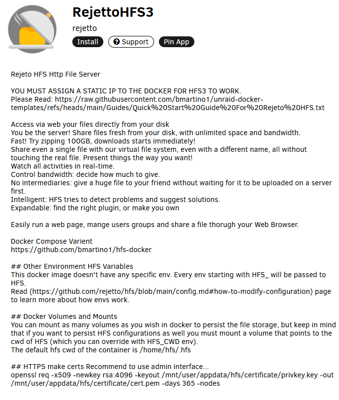

Webdav / Website file access:
Rejetto HFS

So, I would highly recommend using the sftp-fail2ban docker. Unraid does have sftp via ssh, but the fail2ban is important to have to protect unraid from threats and attacks...
