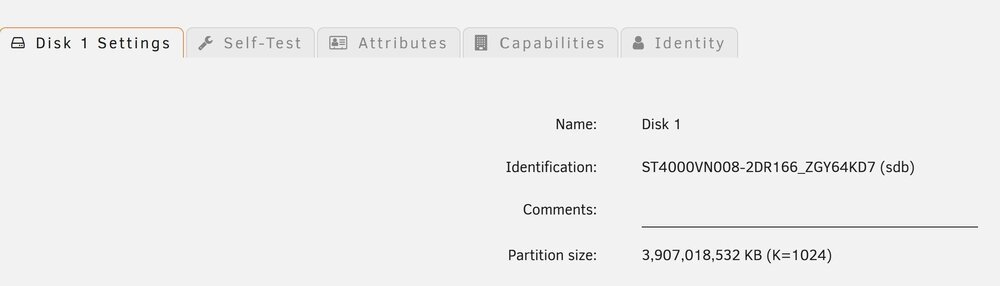

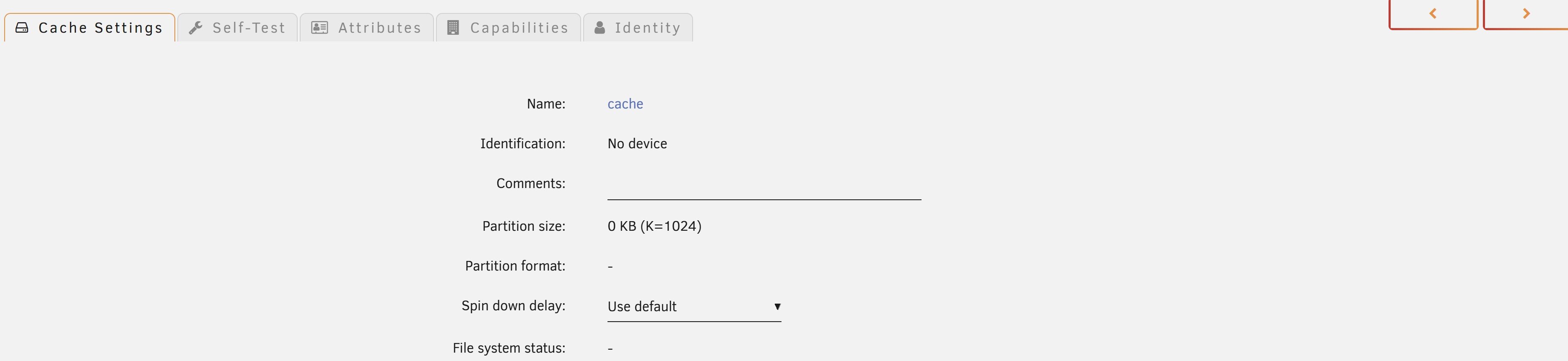

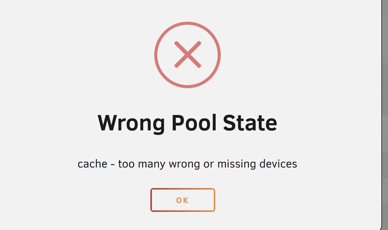

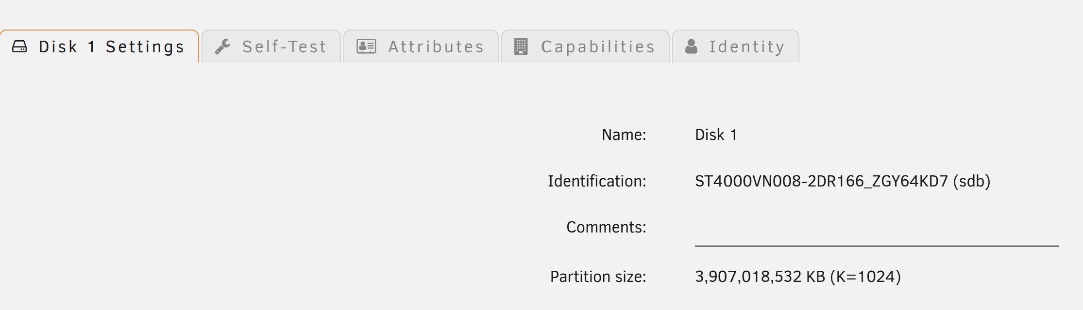

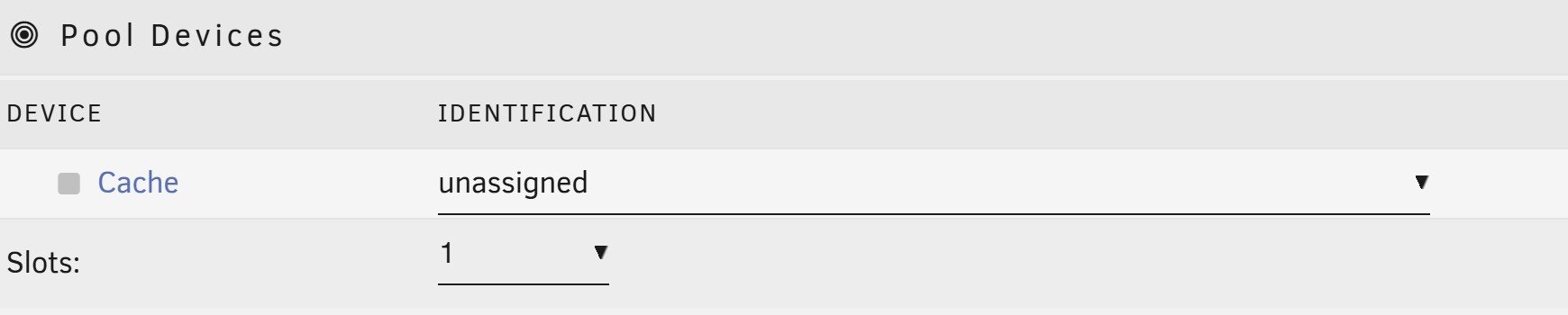

April 22, 20251 yr Hi all So as the title says the Array will not start and I get the error "Wrong Pool State cache too many wrong or missing devices". (Error1.jpg) On the "Main" tab the Pool Devices - cache - Identification is Unassigned. Error2.jpg If I click on Cache the drive doesn't show till I use the arrows at the top of the page then it appears. Error3 and 4 I have read about removing the drives from the pool but how can I do that without losing the data on them. If someone knows and can give me idiots guide that would be amazing. If I don't need to do that any idea would be amazing

April 23, 20251 yr Solution https://forums.unraid.net/topic/184435-unraid-os-version-700-available/#findComment-1508012 You just need to remove the empty pool.
