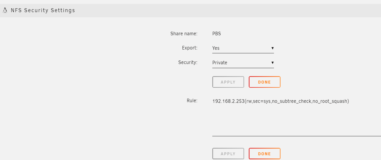

example nfs share for unraid settings

On UNriad adjust nfs settings to match
192.168.2.253(rw,sec=sys,no_subtree_check,no_root_squash)
192.168.2.253 being the Ubuntu machine address to guarantee a secure connection...
this is the bare min for a secure nfs share...
