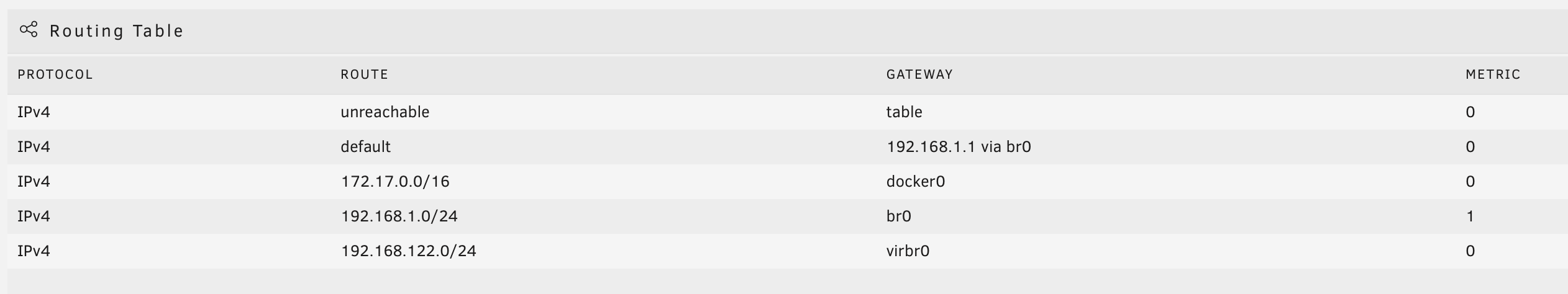

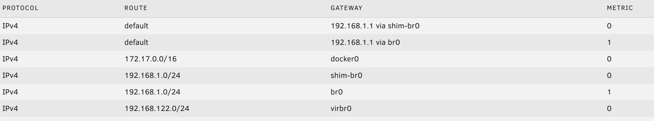

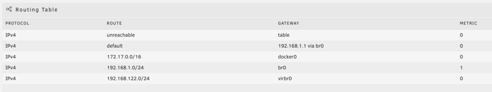

@JorgeB One other weird thing that I just thought of. When the system comes back up after the crash and unclean shutdown, my networking table is always jacked up. For some reason, the shim disappears on restart. Below is the routing table before and after these crashes. Any chance this is related?
Before crash:
After crash and systems comes back online:
shim networks are created when the Docker setting "Host access to custom networks" is enabled, is it still enabled?
Yes. I can fix it by going into settings, disabled docker, and re-enabling docker.
I think that should always appear if HA is enabled, but should be unrelated to your issue.
Ok. That bug has been around awhile, was just hoping it was somehow related. (here is the history on that bug, hopefully it gets included in an update:
