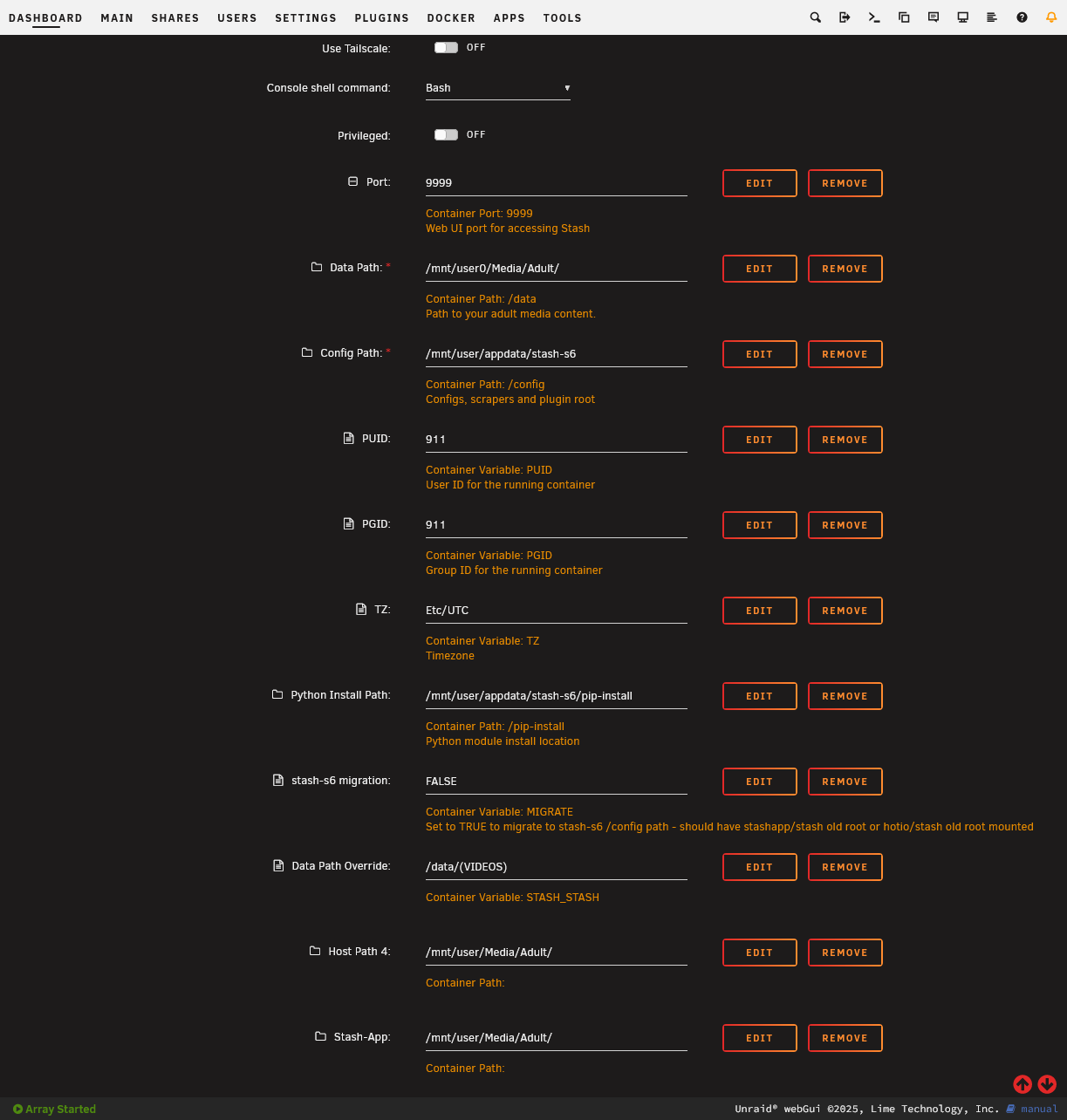

Further to this I have noticed that the mappings of the Docker container do not match the mappings from Stashapp.
My question is which mappings should I alter, container or app?
Your first screenshot shows you trying to access /mnt/user from the container application. That path is the host path to the user shares. The container has no direct access to host paths.
Your second screenshot shows the application trying to use paths /data/(VIDEOS) and /data/(PHOTOS).
Your third screenshot show you do actually have a container path /data, mapped to /mnt/user0/Media/Adult. Why do you want to user /mnt/user0? /mnt/user0 only includes those parts of the user shares that are on the array and excludes those parts of the user shares that are on any pools.
With that mapping, anything inside the container path /data would be at the host path /mnt/user0/Media/Adult. So, using the paths specified in your second screenshot, /data/(VIDEOS) is at the host path /mnt/user0/Media/Adult/(VIDEOS), and /data/(PHOTOS) is at the host path /mnt/user0/Media/Adult/(PHOTOS).
You have several other host paths specified in your third screenshot, but it isn't clear what if anything those correspond to as container paths.
Post docker run for that container.
