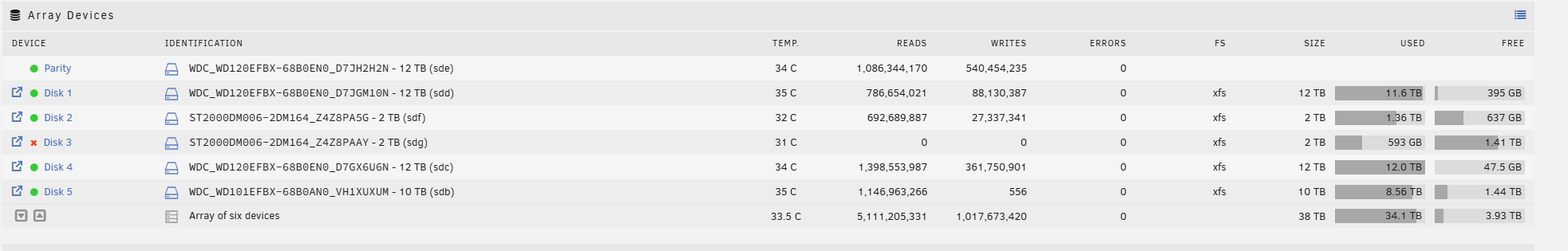

So I have a disk that is device disabled/ emulatedcontents enabled. I am actually not really interested in troubleshooting this disk, because it is a very small (compared to the others) drive that I bought back in 2017. I have been meaning to replace it and another of the same kind for some time, because they are so old and small. So with that being said, I am not really sure of the protocol to do this. I have read over https://docs.unraid.net/unraid-os/manual/storage-management/ and obviously the "Replacing failed/disabled disk(s)" is what I would want, but it says that it wont fix any device that is showing as unmountable. I don't think that my drive is showing as unmountable, but I want to be sure. It looks like this (Disk 3):
So if it is mountable, just to clarify, is that I power down, replace the old drive with new drive, and then when I start the machine again, will it still show disk 3 the way it is above, but then I basically take the new drive in the unassigned devices pool, assign it to that spot in the array, and then Unraid does its things and imprints the emulated contents onto that drive. If I do that, is parity then maintained? I don't need to rebuild it from scratch? Also, how does this work if I do/don't pre-clear the new drive?

SMART for disk3 looks OK, no self-tests have been run on it. Emulated disk3 is mounted.
I don't see any problem with that disk in syslog, which goes back to May 7.  If it was disabled before that, it wouldn't be used anyway.
