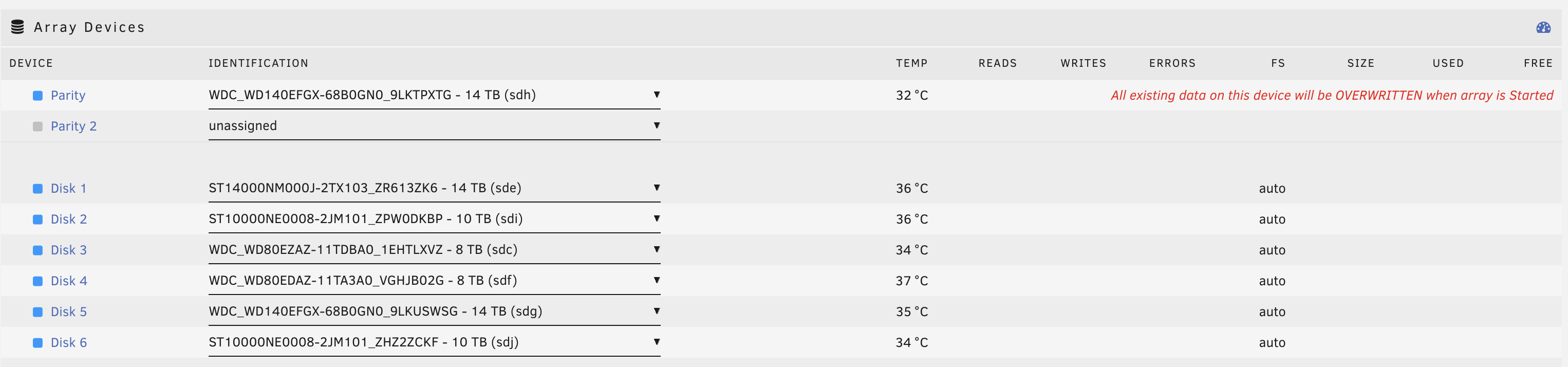

tldr; After a USB failure and replacement (restoring from backup), Unraid isn't automatically assigning my array disks. My DISK_ASSIGNMENTS.txt from my latest backup (May 15th) was last modified April 8th, 2023, and is outdated. I think I've correctly reassigned drives manually, but Unraid shows "All existing data on this device will be OVERWRITTEN when array is Started" next to my parity drive.
My questions are:
a. Is there a file within the /config backup (other than DISK_ASSIGNMENTS.txt) that would definitively show my disk assignments as they were just before the USB failure?
b. Critically, is it normal to see the "All existing data on this device will be OVERWRITTEN" message next to my existing, correctly assigned parity drive after restoring the /config folder? This is my biggest concern.

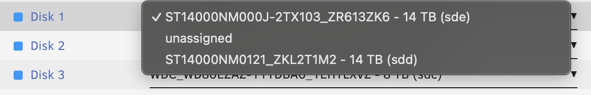

- My SSD and NVME cache pools were identified correctly with their assigned drives.
- However, all my array disk slots were unassigned.
- The DISK_ASSIGNMENTS.txt file within the restored /config/ is mostly the same, but:
  - Disk 1 was replaced about a year ago (from an 8TB WD to a 14TB Seagate).
  - I had an additional spare/unassigned drive in the system.
- I've tried to manually assign all drives to their correct slots based on my memory and deduction. I believe my parity drive(s) and data drives are in their original positions.
- To identify the new 14TB drive (former Disk 1) vs. the spare, I SSH'd into the server, mounted /dev/sde1 (one of the two unassigned drives I was unsure about) and checked its usage:

So Im 99% sure I have all the drives in the correct positions but still seeing next to my parity drive "All existing data on this device will be OVERWRITTEN when array is Started". Is that expected for my situation? Is there anything else I should be doing?
