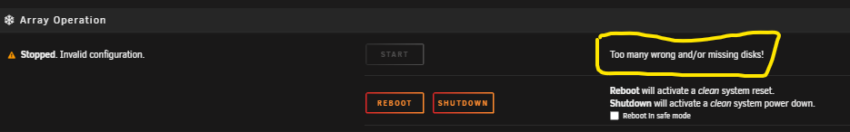

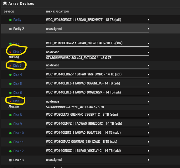

I had two drives fail, and condensed drives and removed a 3rd.  I used the new config option, went and reassigned the drives.  Now I'm unable to start array.  Its says there are too many missing disks (I know,  I removed three).  I was expecting it to rebuild parity using the remaining assigned drives.
Am I not understanding how the 'new config' works?

Solved by choosing 'none' on preserve current assignment on the new config screen
The screenshot you posted suggest you did not hit the Apply button on the New Config screen.
