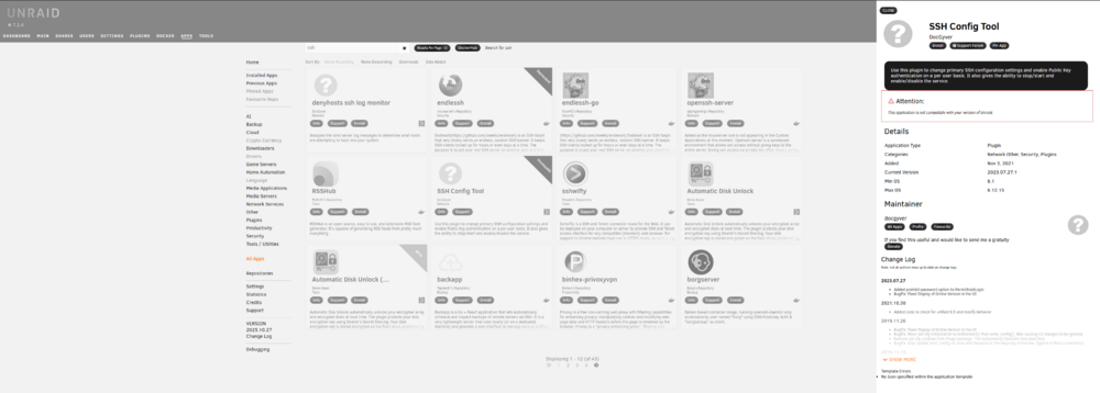

you need to install the ssh config plugin then run these comands otherwise the user home adn accounts won't sruive a reboot..
uses should aslo be made inteh user tab of the unraid web ui terminal to assinge permission...
otheriwse a user script at first array start...

These were working features in the SSH config tool back in unraid v6
