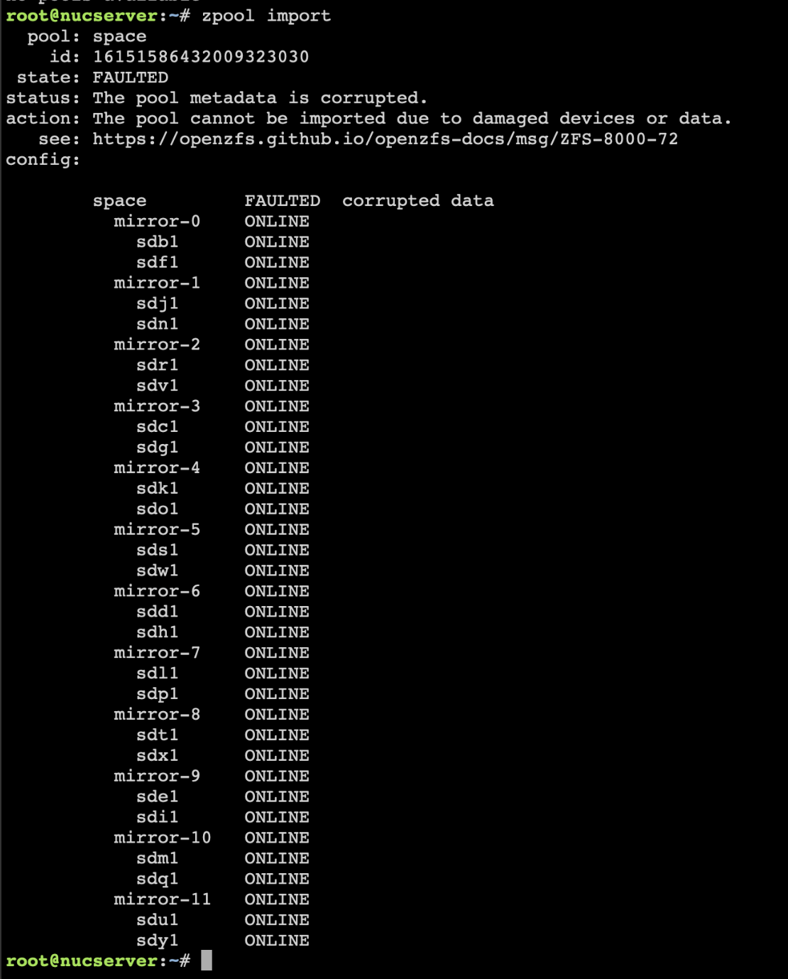

I'm trying to figure out how to get my zfs pool back online. 2way mirrors.
Started as 12x 2-way mirrors, then just earlier today, I added 3x 2-way mirrors to the pool.
They were added correctly, and everything was fine, until a power issue caused those 6 drives to cause errors.
I was able to successfully complete 'zpool remove (name) (mirror-set-name) on the 3 new mirror sets. ** But the slots were still present on the unraid pool page.
During me trying to get those drives out of the pool, I removed the pool from unraid.. I tried to re-add it with the original 24 drives (12 mirror pools), but I am not getting the error "Unmountable Unsupported or no file system.
No Data had been written to the "3 new mirror sets" and as I mentioned, they were removed successfully and quickly.
Attached diagnostics.
Thank you to all that can help!
That pool will most likely need to be destroyed and recreated, but you can try to force import, if it works there could be some data loss, typically the last few seconds or a minute of writes:
zpool import -F space

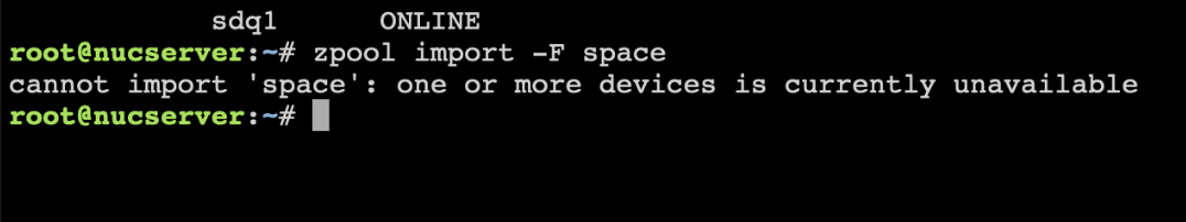

As always Thank you @JorgeB you're the best.
I too have been thinking that the pool is lost.
When I try the above I get:
I think so, best to destroy and restore from a backup, if there's no backup and important data, a data recovery app may help.
