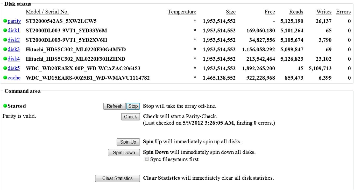

I would rebuilt the red drive. This is the safest option.
Thank you, I will do that when the current reiserfsck is finished...or when I get back home from work in the morning, which ever comes first...  ;)
Looks like everything is fine.
Thanks for all of the help !! Just in from work going to pass out now.....
