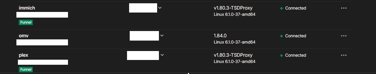

what does it look like then?
OMV being the Unraid host name that the tailscale docker added...

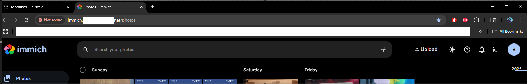

so now if i go to immich.<tailscalname>.ts.net
I hit my web UI
docker-compose.yml tsdproxy.yaml

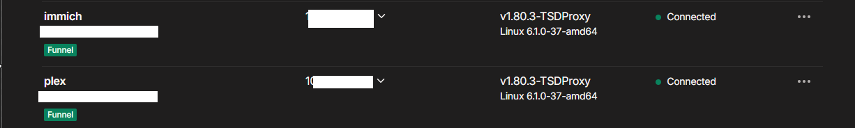

Small docker compose update... The above compose will work, but if docker compose down, and docker compose up. This may make duplicates machines in the tailscale admin interface, This is due to the tailscald not having a state file and keeping machine identity... A simple command file to the tailscale sidecar docker method... as the machine identity is not saved and is removed at compose down removal...
Simple fix though.. Add the tailscal state file:
command: tailscaled --state=/var/lib/tailscale/tailscaled.state
*add this under tailscale docker compose section...
With this options added. I had to remove the machines form the tails scale admin interface and when I composed up I only had immich and plex no omv (the urnaid host)
Updated example Fix tailscale state file

Recommend fixing to not cause tail scale device duplication:
*I also recommend running watch tower as host setting labels to update compose dockers on unraid...
What the admin interface will look like after comand added:
docekr-compose.yml

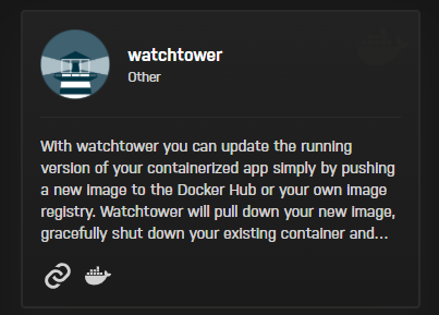

Watchtower docker in compose
#version: "3.8"
services:
watchtower:
image: containrrr/watchtower
container_name: watchtower
restart: unless-stopped
network_mode: host
volumes:
- /var/run/docker.sock:/var/run/docker.sock
command: >
--schedule "0 1 10 * *"
--cleanup
--include-stopped
--label-enable
labels:
- "com.centurylinklabs.watchtower.enable=false"
