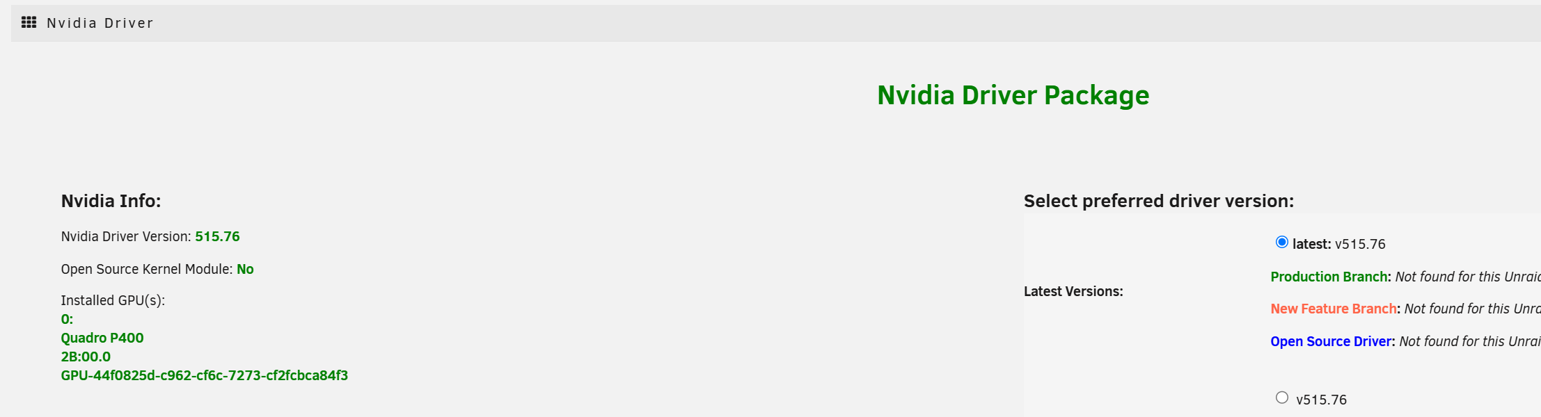

So I have a NVIDIA Quadra P400 GPU installed, x16 slot.
Drivers are insatlled & running, Nvidia Driver Version: 515.76 (had to replace the USB boot disk because it didn't have enough room for them).
I have a GUID for the board.

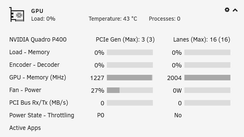

I also have GPU Statistics Plugin installed & it can see the GPU.

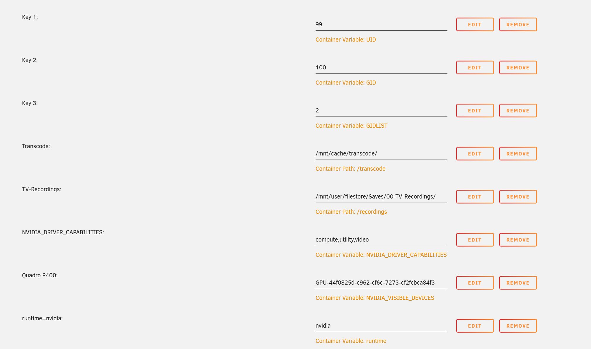

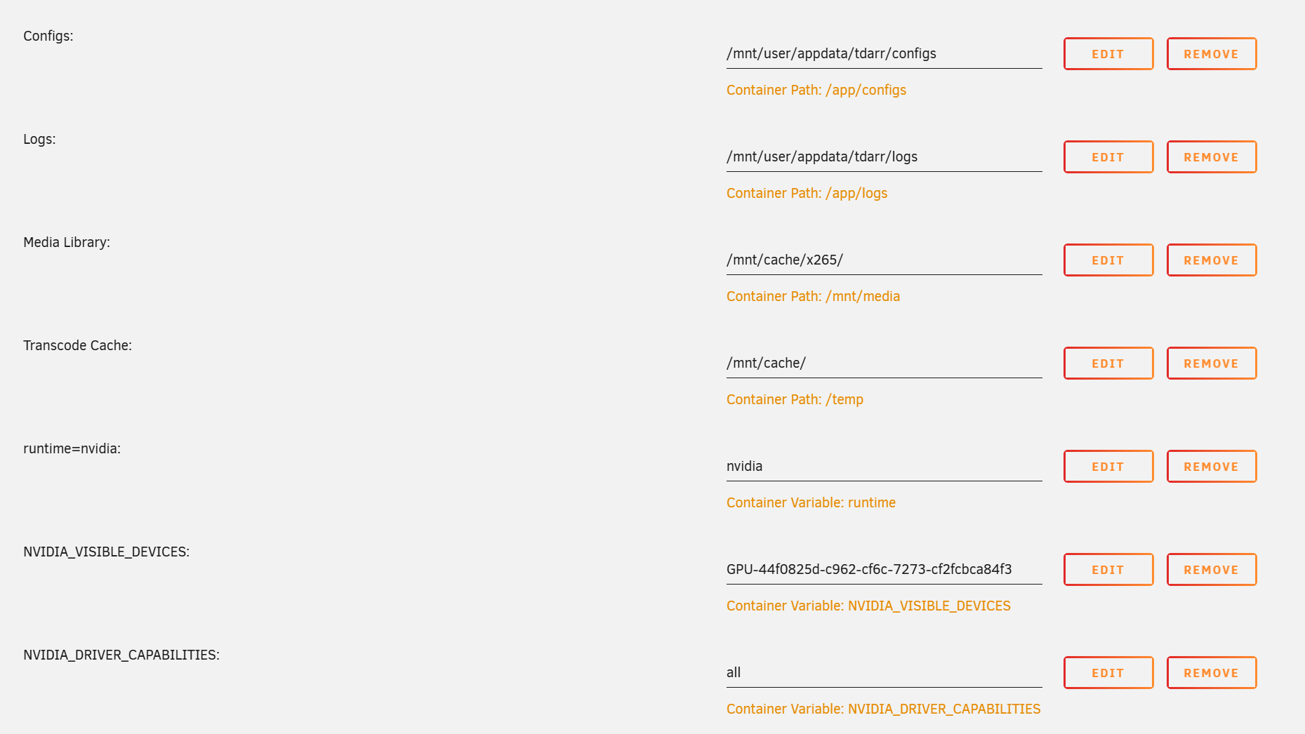

But I don't seem to be able to use it in either Emby or Tdarr.
(I think) I've found all the extra variables I'm supposed to be using (according to some convincing looking sources), screen grabs attached
However, there's no clues that the emby or tdarr can see the GPU, not listed explicitly, and definitely not being used, according to the CPU stats & the GPU stats.
I'm clearly missing something, or have got it wrong somewhere, please help me & nudge me in the right direction?

I thought the runtime=nvidia went into the Extra Parameters field (only visible if Advanced View toggle on)?
Thanks very much - that's a perfect answer.
Much appreciated.
Specifically
--runtime=nvidia
inthe "extra parameters" section as you say.
However - the double dash before it is vital - it fails otherwise.
Yup that worked - thanks for the nudge!
