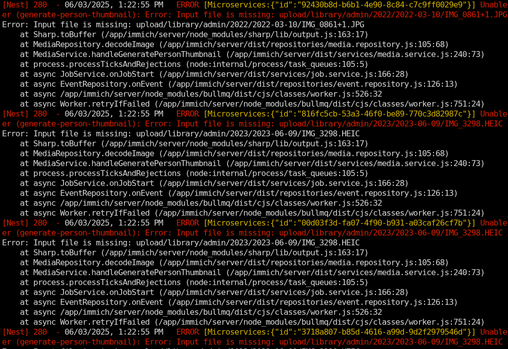

Installation and configuration went smoothly, and the import of the Portgres database was fine. I logged into Immich and none of the images would display. At first I thought it might be a user and group issue so I changed ownership to abc:users. That didn't help. So then I changed the permission of the directory first to 755, then 775, and finally 777. So no good. I then thought maybe it was a thumbnail issue so I backed that directory up and tried to recreate them and that's when I noticed in the logs Immich is claiming the actual photo files are missing.
So I went to the directories and they are there.
Does anyone have any idea what's going on? The file is there and in the right place yet Immich can't find it. Any help is appreciated.

The issue appears to stem from some form of Postgres database corruption. As long as the physical file exist this is recoverable.
Your Postgres appears to have broken and missing metadata and additional data for files that are either in a different path or moved when original metadata was grabbed / existed.
(Per the log)

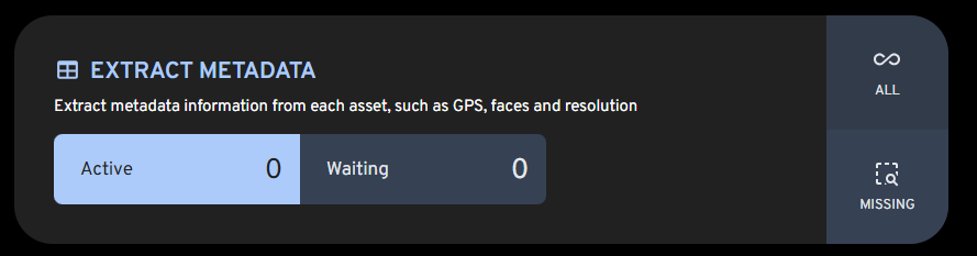

at the tabs in the Left go to jobs:

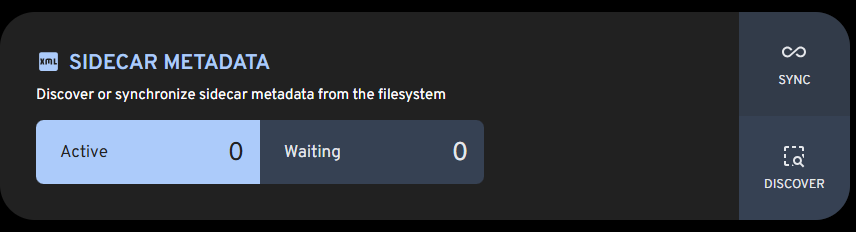

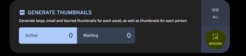

Here we need to run jobs to collect and refetch data that existing and is missing...
I would recommend running all the jobs clicking missing next to each option in this.
Example:
These will scans and will put the unraid system under load. Jobs will need to finish before touching or editing Postgres database.
