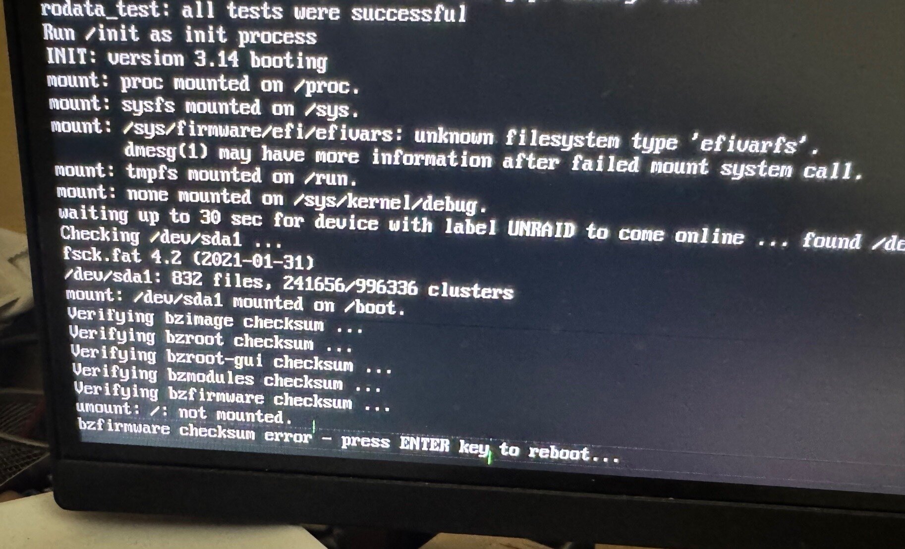

Hi my server has just started to randomly power of when I try to restart it now I get bzfirmware error - press enter to reboot which did work but now just keeps doing the same. Any help appreciated

If the server is still rebooting/shutting down on its own, that's typically a hardware issue.
Thanks for replying same hardware for past 18 months only thing changed was upgrading to 7.1.3 have turned back to 7.1.2
7.1.3 uses the same kernel as 7.1.2, so likely just a coincidence.
