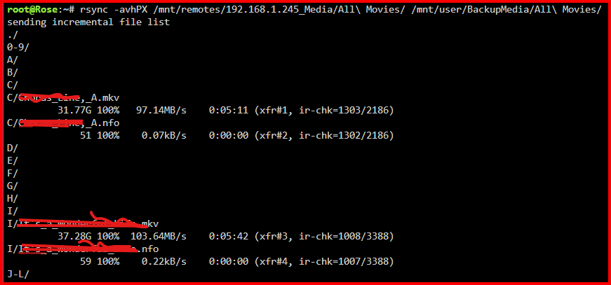

June 12, 20251 yr Community Expert 12 hours ago, Duane said:All is pretty much well, but rsync complains about a lot directory timestamps being different. I think this is due to the way Unraid and shfs handle split directories. It seems like the mtime returned for a directory is always the most recent, which is making rsync claim it is updating timestamps on any folder which is split on the destination side.What do you mean by the word "complains"? Is it merely listing that it changed the timestamp or is it an actual error statement.Are you using rsync in a script? If so, how are you handling the command's std out.I use rsync in a Command Line command and std out goes directly to the Terminal screen. My directory times are updated but I have never seen any notification of that event. But I only have about fifteen directories. This is what a portion of my typical output looks like:HAve you tried the -q switch to silence the output? Edited June 12, 20251 yr by Frank1940
