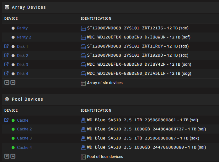

The general consensus is that SSDs should not be placed in the unraid array but in pools either mirrored or zfs raidz modes.
HDDs can either be pooled or be placed in the unraid array.
With that said your two NVME disks would be more appropriate for a pooled configuration and the 8TB HDD should be Disk1 in the unraid array. You'd want to get a 2nd 8TB HDD if you wanted to add parity.
See below, HDDs up top, SSDs at bottom. HDDs are single disk filesystems, the Cache pool is a zfs equivalent of RAID 10

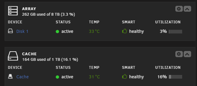

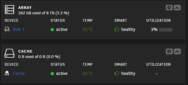

I got the 8TB in, performed a config change and formatted the 8TB. I set the 8TB as disk1 and without making any other changes I put the NVME that was previously disk1 in cache pool 1 slot. When I started the array it fired up and showed the 262GB that was previously being used on the NVME as used on the HDD but there are no files present when I go and look and cache is showing 0 B used of 0B. I might be jumping the gun time-wise or I might not have performed a step properly. I see the 262GB being used by the 8TB as a good sign though.
I might know what I did. I'm making the change now but I might have put the previously unused NVME in the cache instead of the used one. I'll update if that's the case
Yes, that was it.

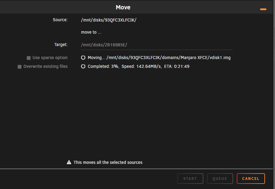

I believe I've worked my way through the data migration. Stopped the Array and mounted both drives via the UD plugin, went in and deleted empty pre-made folders on the HDD and then selected the SSD and am currently using the move function to transfer all files. What could go wrong, right...?
